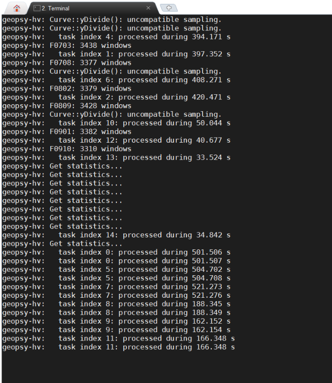

Note that geopsy does not necessary need traces to be cut for processing arrays and H/V, instead time range to process can be specified in the parameters. You can try the latest command line tools geopsy-fk, geopsy-spac and geopsy-hv for massive datasets (in 3.3.0 out in a few days). For instance, a script may loop over several days just providing a sliding time range and keeping other parameters constant.

Re: Windows command line
Version 3.3.1 is out now
