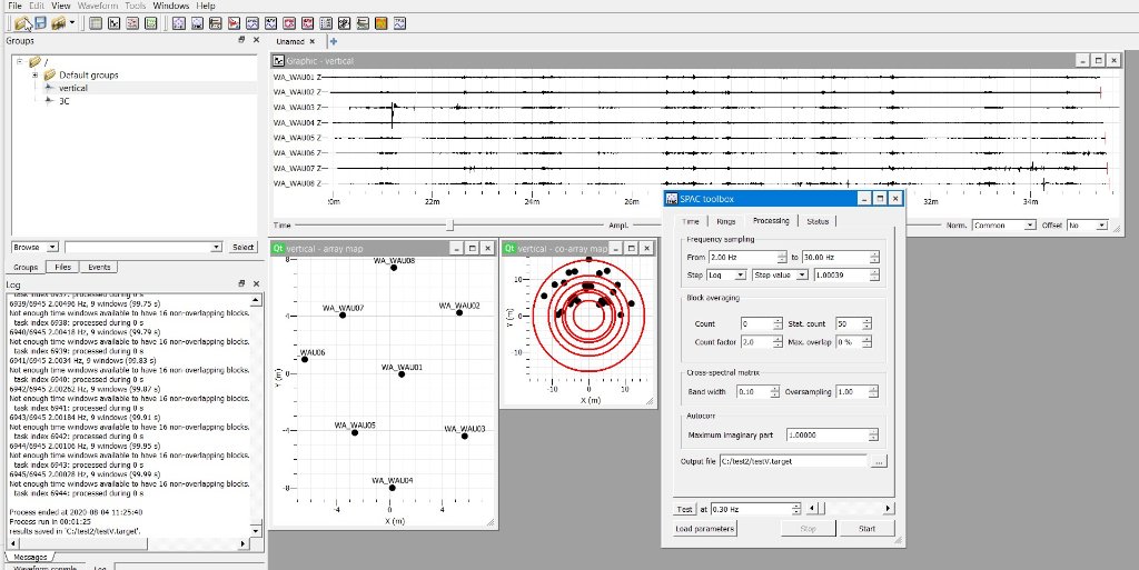

About the first point I tried to run SPAC using your database Lep_ring01.
The tool worked nicely with V data, but crash immediately with 3C data. I attach the screenshots for V and 3C parameters setting (I used exactly your rings dimensions) and, for the last one, the crash report too
(131.76 KiB) Not downloaded yet
(108.22 KiB) Not downloaded yet
