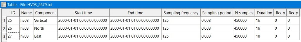

I renew a question from some time ago concerning the fact that a .log file created with Geopsy with a version later than 3.0 is no longer read by the same release after some time and after installing later versions (but I don't know if this is a determining factor). I bring you this example of a .log file created with the 3.3.2 release in 2020 September (HV03.zip). Today I reopen the same release and I try to reload the same time windows saved through the HV03.log file to review the H / V plot, but nothing happens (0 windows to read) and this script appears in the log window:

From the image of the table (table.jpg) I seem to understand that the data format is the right one and therefore I do not understand the reason for the impossibility of being able to recover files already processed not only with subsequent releases, but not even with the creation one.
There is certainly a reason and I hope you can identify it and suggest the solution.
