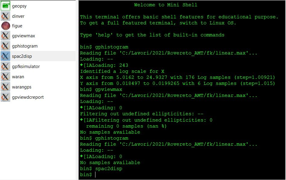

trying this version i verified that spac2disp doesn't work.

it just doesn't start. When in geopsyland I type spac2disp nothing happens and the same happens if I click directly from outside of geopsyland on spac2disp.

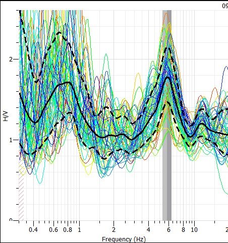

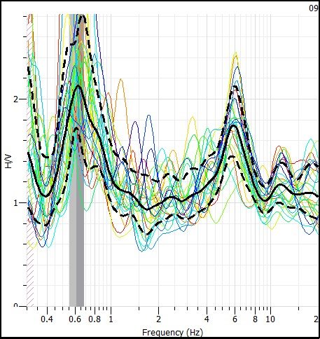

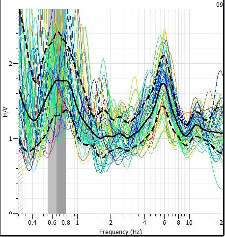

I also tried the new Frequency Rejection utility. I also read the paper and I noticed that the parameter n (or v) is crucial to significantly modify the morphology of the HV curve. I am attaching three pics where the raw HV curve (geometric mean) is represented and the result of the Frequency Rejection with SD 2 and 1.5 where the peak at 0.6Hz gains in amplitude exceeding the value 2 and satisfy the SESAME criterions for natural HV peak.
Which criterion should be used for this parameter? Can the result I obtained with SD1.5 be considered correct?
And finally, when is it preferable to adopt the geometric average rather than the squared average?

spac2disp is now fixed in 3.4.2-preview (git repo).
The geometric average suggests that the E and N are two quantities that are better represented on a log scale. However, I see E and N as two components of a vectorial field, hence the combination through "Total horizontal energy" sounds better. The "Square average" is the same with a factor sqrt(2). I would say that for historical reasons the last one is mainly used.
I also noticed that a factor 2 is not removing many time windows. 1.5 is more effective. Is it better? The uncertainty is reduced but is it more accurate? I have no answer.

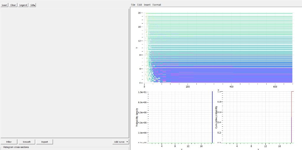

Finally I found that gphistogram opens the max files of HVTFA, but it represents them in an incomprehensible way. I am attaching a picture.

Yes, there is still some work to really read those .max files into gphistogram.
