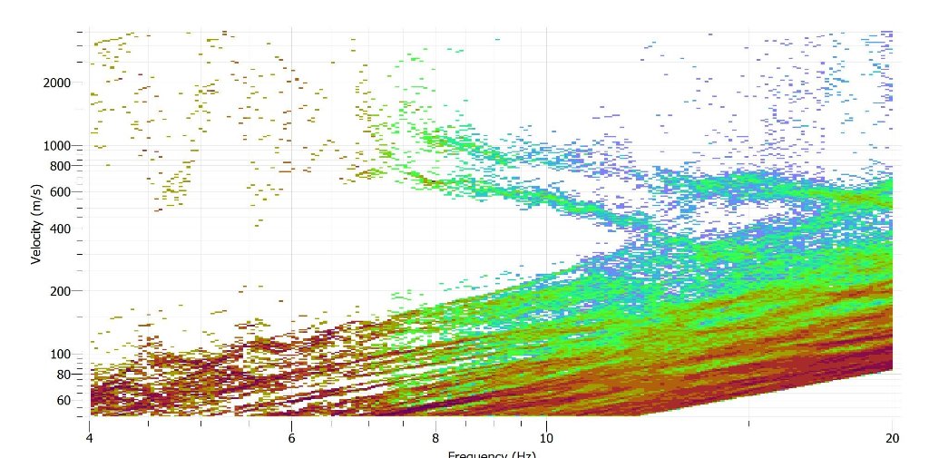

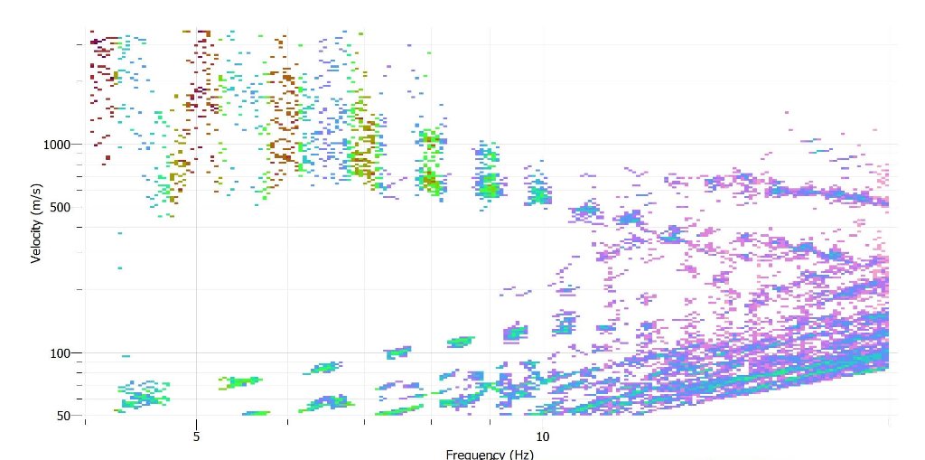

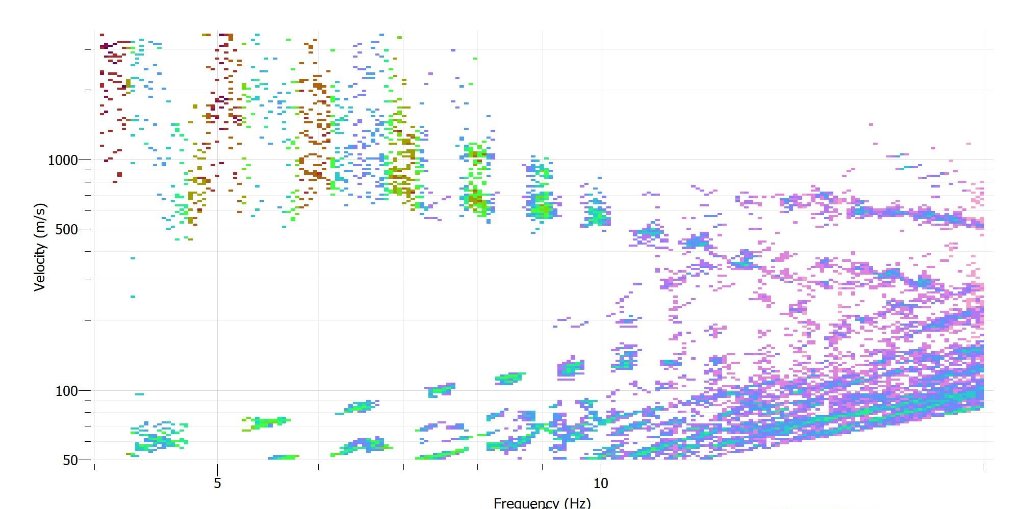

today I have processed a minishark dataset (7 stations 3C) with FK tool (RTBF). The .max file was obtained correctly, but using gphistogram I cannot use any print options (-p). If I don't type anything after gphistogram I can open the file.max and Rayleigh's slowness-frequency plot appears. If I type -p R (or L, or -ell etc) this message appears:
"bin $ gphistogram -p R
Reading file 'C: /Lavori/2021/IND00/fk.max' ...
Slowness max file with pattern 'R'
Loading: ----
[1ALoading: 0
No samples available
bin $ "
If I run gpviewmax I can see all plots perfectly (R, L, ell, azimuth, noise, power).
Also if I run RTBF radial (which should be the rerun for Love, is that correct? Because other options are not there to get L dispersion, as you have recently suggested) the program crashes.
I have also been able to verify that gphistogram of 3.3.6 works perfectly with RTBF max files of 3.3.6., but it does not read files.max of 3.4.1.
RTBF Radial of 3.3.6 runs correctly.
ps: I would like to know why there is such an obvious difference, not only cosmetic, for the "passive RTBF" outputs generated by 3.3.6 and 3.4.1 on the same data set and with exactly the same parameters
(144.69 KiB) Not downloaded yet
(109.48 KiB) Not downloaded yet
Re: problems with gphistogram and RTBF geopsy 3.4.1.
In the original implementation of RTBF, Love wave were computed at the same time. The .max files were containing both types of waves with a column dedicated to a flag: "Vertical", "Rayleigh" or "Love". This discussion may bring interesting explanations.
"RTBF Radial" is still a RTBF process that produces Rayleigh dispersion curves. The "Radial" option acts on the type of power. "RTBF" uses power P^{prime}_{R_s} as defined in Wathelet et al. (2018) which is theoretically insensitive to incoherent noise. "RTBF Radial" uses power P^{prime}_{R_h}. The latter is biased by the incoherent noise but it is more stable for ellipticities approaching zero. It is good to run both options.
On branch 3.3, there was the additional column for the type of wave. The contrary should work. If not there are scripts to translate them.
The output of 3.3.6 looks effectively strange. I worked on RTBF implementation between 3.3 and 3.4 to fix various issues (details can be found be checking the differences in git repository, but I can't remember). I would better trust the results of 3.4.1. Currently working on 3.5, I found again minor errors in 3.4.1. They are fixed in 3.4.2 to be publish soon.

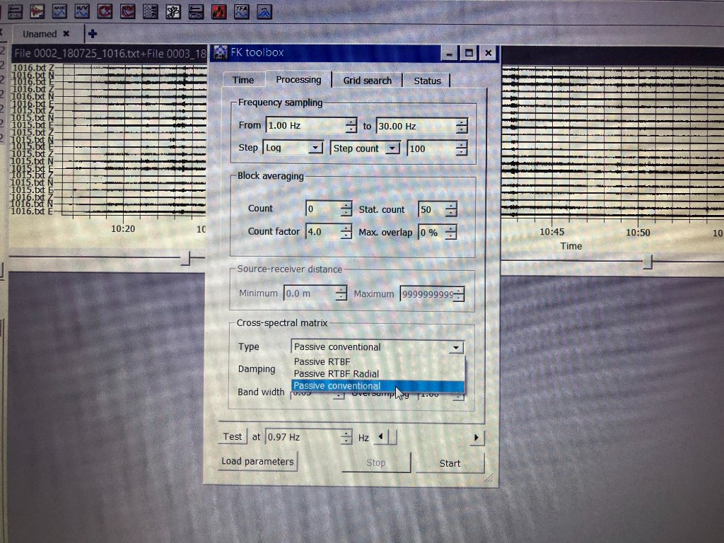

How I have to do to run the CaponTransverse graphical interface?
Go into the FK toolbox, with 3.4.2, the list of available process types has been updated. If you provide horizontal or three-component signals, "CaponTransverse" is available. Not with only vertical components.
Sorry, but as you can see, in the release 3.4.2 downloaded, CaponTransverse is not in the process list.
