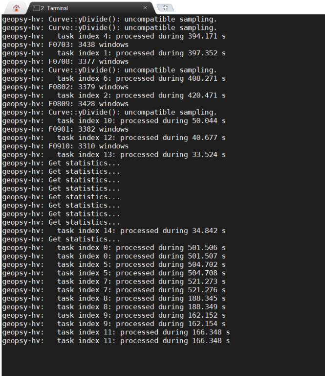

I wondered if there is any way to create the database for geopsy-hv using the command line instead of using the GUI?
When I run only 1 station data using geopsy-hv, it works well but when I give it a larger database consisting of a few more stations it stops. (screenshot attached).

Thanks for the update. I wondered what command I should use now instead of -db for the list of files? I use geopsy-hv -db filename -param filename
what is the modification I should make now? Thanks a lot!
Re: Windows command line
You can skip the option '-db' and just list files. Even for .gpy files you can skip '-db'
