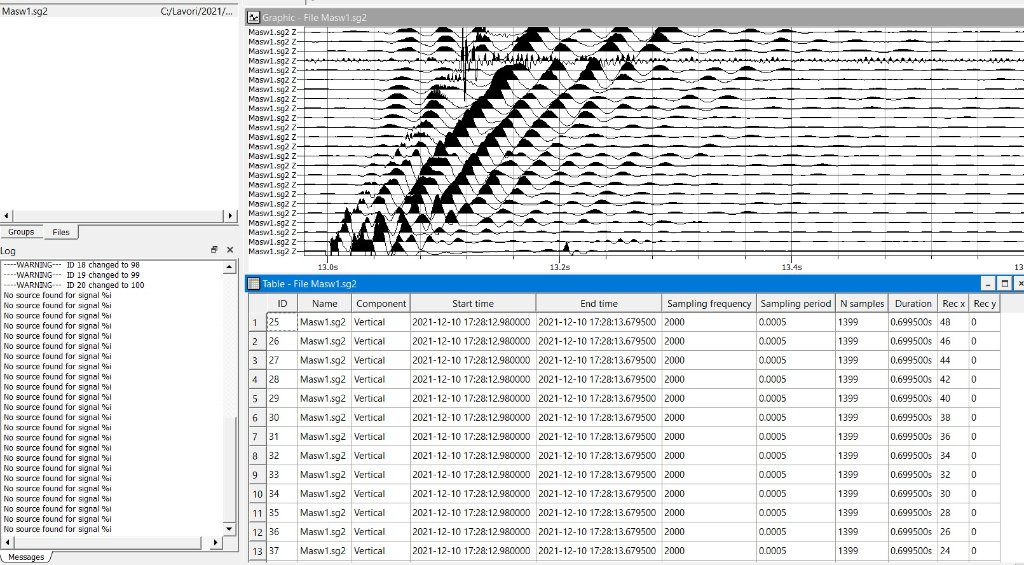

I have some active seismic datasets that Geopsy 3.4.2 is unable to process because in the message window it tells me, for all 24 tracks, "No source found for signal% i" (see figure).
The same thing also happens with the file in txt format, while version 2.10 has no problem processing both the sg2 and the txt file.
Previously it had never happened and therefore I must assume that it is an error of the data logger in exporting the files from its proprietary format. The significant thing is that this "bug" is dramatic only for Geopsy versions above 3.0.

Check that the Event table contains a source that corresponds to your signal (compatible location and shot time inside the recording range of your signals). Normally for SEG2 format, a source is automatically added to the table so that things are transparent for the user. If no source information is available in the header or if another format is used, you must manually edit this table (next to Groups and Files).
The strange '%i' in the message is fixed for the next release (if not for 3.4.*, it fixed for 3.5.0).
