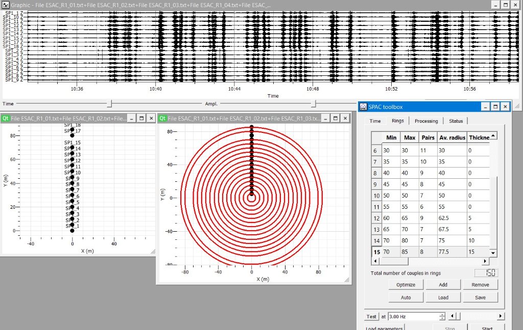

I submit this new problem that always concerns the auto option with linear array and Spac.
The array is made up of 18 stations spaced by 5m, acquisition time 25 minutes (station 16 was cut because of bad quality).
Entering the coordinates in the table with increasing x (y = 0) and applying Spac does not activate the auto option (see x_coord.jpg).
If on the contrary the coordinates are for increasing y (x = 0) the auto option works correctly (see y_coord.jpg).
Is there an explanation for this?
Finally, is a setting with a 5m rings thickness correct compared to the automatic one (0m)(rings_setting.jpg) ? The target file with 5m rings thickness seem to me more defined than 0m thickness one (comparison.jpg) Do you agree?
Thanks and best regards
luigi

Re: more on auto option using Spac
I checked the "auto rings" along X or Y on a sample data file: it works equally in both directions with the latest release (3.5.0-preview). The problem you encounter is probably linked to a bug on the current release. Thanks for your vigilance.
About the thickness of rings, I have no particular opinion. The zero thickness is closer to Aki's original SPAC. Having a look at your plot, I could see very little difference. If you prefer the 5 m in this case, maybe that for another case the 0 m will be better.
