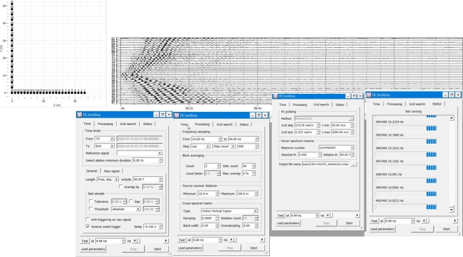

Thanks Marc,
but I would like to submit the case of an active L shaped array that you see in the attached image (shot at 0,0, sampling frequency 2000) where you will also see that the program does not work, trapped in a loop from which it does not exit.
What's the reason?
Is the acquisition time of 1 second enough (I think so)?
is there any other parameter to set?
or is it a bug like that of the passive linear array (which I hope will be solved in the new and top realease 3.5 cooming soon (?)?)
Best Regards
(91.76 KiB) Not downloaded yet
