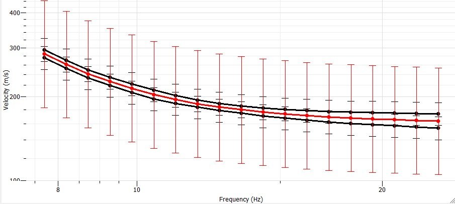

I have tested previous dispersion curves that correctly represented 10% with 0.1 and found that they all now have the anomaly of representing 10% with 1.1.
Previously I had recorded that the mean curve automatically provided absurd standard deviation bars, equal to the ones I now obtain by applying an SD of 0.1 (the two curves to be averaged have no SD, see attached jpg).
If I apply an SD of 10% with 1.1 to the two curves, I obtain an average curve with an SD that is >30%. Is it wrong or am I wrong (see the jpg STD_average_1)?
