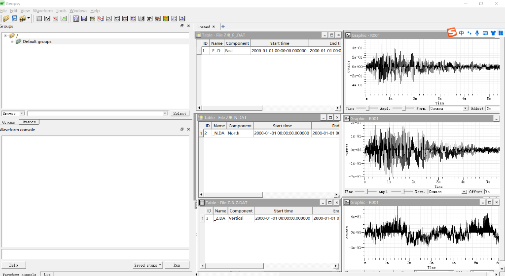

I am a newbie and have just downloaded this software. I wanted to use this software for H/V calculation, but I imported the data and set the header for each data.
But I clicked the H/V tool, and nothing happened. I'd like to know how to solve this problem.
Thank you very much.
Peng Zhao
(130.54 KiB) Not downloaded yet
Re: H/V tool
Hi Peng,
Did you try to put all three signals in a single viewer? You can use drag and drop to move signal between viewers. With a graphic, all signals are considered. With a table, you can select a subset and create a new viewer by dropping them to the viewer icon in the toolbar.
Once you have a viewer with the three components you can start H/V tool.

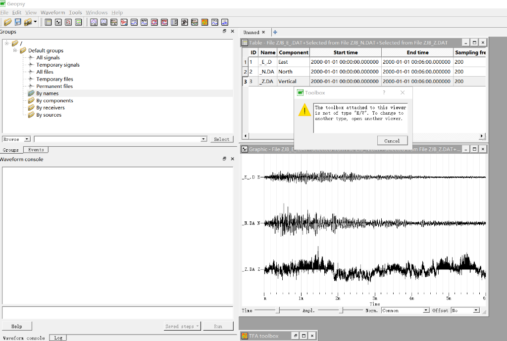

Hi Macl
I did as you said, but I still can not use the H/V tool, and gave the prompt message.
Kind Regards.
Peng Zhao
(166.64 KiB) Not downloaded yet
Re: H/V tool
There is already a toolbox attached to your viewer (TFA). Move your signals to a fresh new viewer. Close the former one and start H/V when the new one is active.

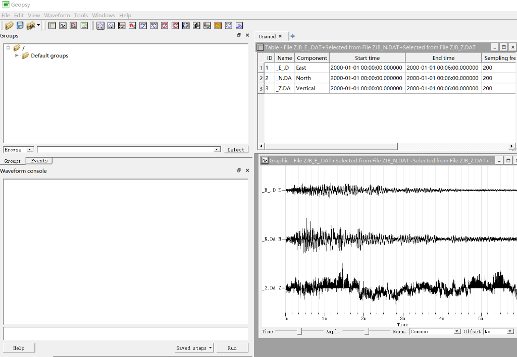

Dear Macl,
I ended the program and started importing data again, but it still didn't work. I don't know what the problem is.
Thank you very much for your patience
Kind Regards
Peng Zhao
(140.49 KiB) Not downloaded yet
Re: H/V tool
At the step shown by your last snapshot, what is the error message you get when you select H/V tool in waveform menu or in the toolbar?
