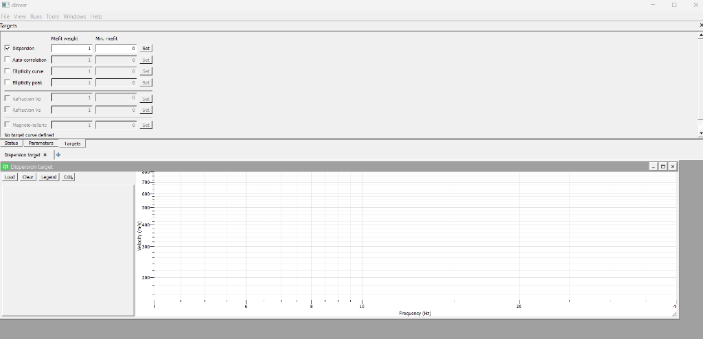

I want to input a target dispersion curve with three columns ( Freq, Vs and Std Deviation) as below:
5.26680518 579.8337186 28.99168593
6.742006858 610.1156964 30.50578482
8.300384078 612.9458131 30.64729066
10.02168433 548.5103806 27.42551903
12.09994089 475.2021826 23.76010913
14.32713359 404.140583 20.20702915
19.69903558 411.6915966 20.58457983
29.66475772 402.2745697 20.11372849
36.0500185 326.6463197 16.33231599
But when I load the above target dispersion curve file ( shown in the attached image file), I get a blank target dispersion curve (shown in the attched image). I want to show the target dispersion curve with std deviation lower and upper bounds.
Please help me.
(48.42 KiB) Not downloaded yet
(90.34 KiB) Not downloaded yet
Re: Dinver Related: How to input a Dispersion target curve containing freq, Vs and Std deviation
Strange. I checked with your curve without getting any problem except that standard deviations are not visible. This is a minor issue with <=3.5.2 that will be fixed in 3.5.3. It can be fixed by clicking on Legend button and by setting the width of pen to something else than 0.
If nothing is loaded, you may check the log messages (menu Tools/Log).
