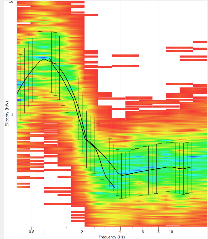

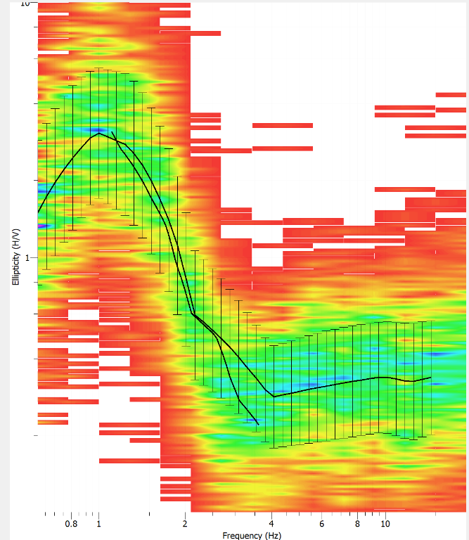

1. After loading the .max file into max2curve, the curve at the right window is essentially the fundamental mode Rayleigh wave ellipticity forward model I believe?

2. From here, we pick either left flank, right flank (or a combination), or the entire curve itself and save it as a multi-column file. Or do we just resample the existing curve into the left or right flanks such that the standard deviations are not lost? Here is the right flank as an example:
(325.34 KiB) Not downloaded yet

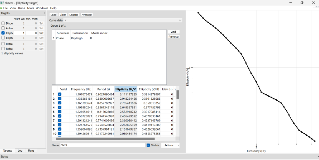

3. Say we proceeded with the picked right flank, load the curve into Dinver.
(145.54 KiB) Not downloaded yet

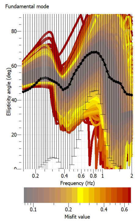

4. The resulting output of ellipticity (colored lines) are the numerical forward models fitting the experimental forward model?
(169.74 KiB) Not downloaded yet

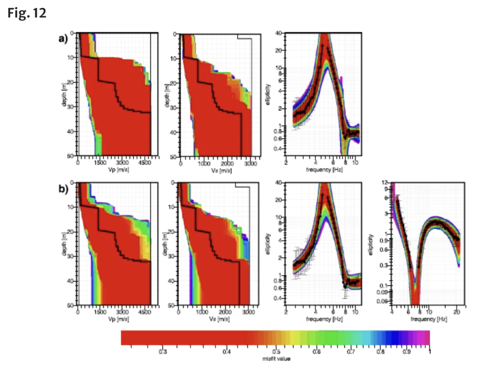

I guess ultimately, I would like to produce something similar to the output of Knapmeyer-Endrun et al. (2017) https://link.springer.com/article/10.10 ... 016-0300-1:
(452.62 KiB) Not downloaded yet

1. The results of HVTFA depends upon the criteria used to selected events (max2curve -h TFA for a list of filters). One of the simplest filter is '-tfaNppm' (maximum number of peaks on the vertical component per minute and frequency). If you increase this number the obtained curve should tends to the H/V computed in the classical way (with combination of horizontal components 'Total horizontal energy'). With a more selective condition, you should tends to the Rayleigh ellipticity curve. The good choice is case-dependent, usually lower for deeper sites.
2. I prefer to keep the standard deviation.
3. Dinver is now processing the angular ellipticity (atan(H/V)) instead of the plain ellipticity. In you image it is still with plain ellipticity. I guess this is an old release.
4. They should fit the experimental data... in your case, they don't.
5. If you invert the ellipticity curve alone, without any information about Vs, there is a trade-off between depth and velocity a bit like in the classical formula Vs/4H=f0. The curve, compared to f0 only, does not help so much to solve the ambiguity. Hobiger et al. (2013) shows this clearly on various examples. If you have MASW data to invert with, it is fine even if it provides only the high frequency dispersion curve. Re-reading quickly Knapmeyer et al (2017), I understood that they processed only numerical simulations.I'm unsure you can obtained similare results with experimental data.

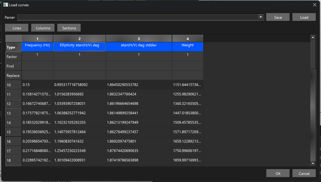

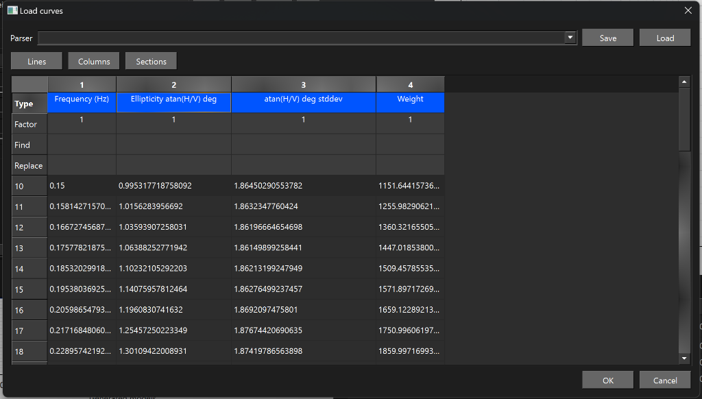

What should be the column designations when importing ellipticity I obtained from the old max2curve if I wanted to use the newer dinver version?
I have tried the default but am getting larger misfits as compared to the older version.
In the newer version I am getting as high as 10 whereas the older version, never larger than 0.5.
(131.43 KiB) Not downloaded yet
Thank you!

If the number are coming from max2curve, you have to change the column headers. Values are not in degrees. You have to select 'Ellipticity (H/V)' for the mean values. For the error, I'm not so sure. It should be 'H/V stddev (approx)' or 'H/V*stddev (approx)'. Try both and compare with the plot of max2curve.. What's best?

The ellipticity I got after inversion is this:
(208.83 KiB) Not downloaded yet
With ellipticity angle (deg) as the y-axis
With very low misfit as well (quite happy with it actually)
The error bars though look very large
Please let me know your thoughts. Thank you!
