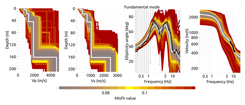

Thanks so much for your reply. I have attached an example of joint inversion with ellipticity from HVTSA and the dispersion curve. In my ellipticity curve, the right flank is hard to see. Is it okay to use the whole curve for inversion here?

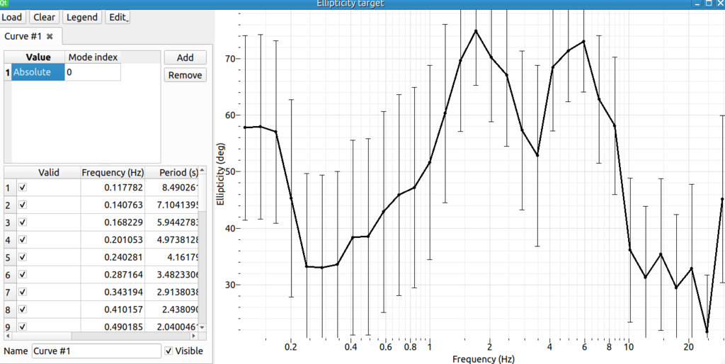

Hobiger et al. 2013 also tried successfully to invert both flanks. Your profiles nicely reproduce the observed ellipticity curve even if it is not perfect. Just one detail, the errors look rather large. I'd like to make sure that there was no error while importing this curve into dinver and the conversion to angular ellipticity. Which columns did you select when you imported the curve produced by HVTFA?
The dispersion curve between 5 and 10 Hz, is it from MASW or ambient vibration arrays?

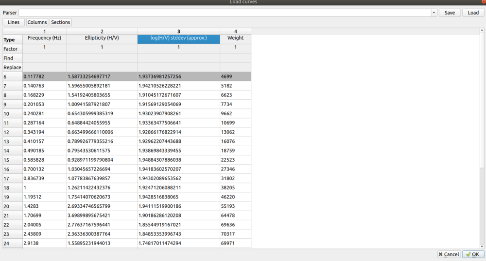

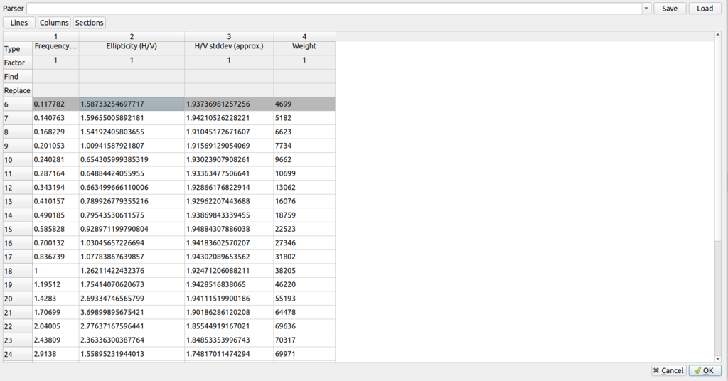

When I import the curve to Dinver, I selected 'Ellipticity (H/V)' for the mean values, and 'H/V stddev (approx)' for the error. I also tried to select 'log (H/V) stddev (approx)', and the error looks similar to the one in maxcurve. However, when I run the inversion, the curve imported with 'log (H/V) stddev (approx)' has a larger misfit than the one imported with 'H/V stddev (approx)'. Could you give me some suggestions on which one is correct?
The dispersion curve I used is not from MASW, it is measured with ambient-noise cross-correlation of a 2D seismic survey line very close to my stations.

I know that time has passed since you message. Do you still have the plot of H/V with non-log stderr?
Are the errors larger with log stderr? Or the contrary? At first glance, the misfit can be larger if the uncertainties are smaller.
I checked the code for importing H/V curves inside dinver. For curves stored in files .hv, the stddev was not computed correctly. This is now fixed in the git repository. If you produced the H/V curve in max2curve (result of HVTFA), the error should be log (I did not check in max2curve).
