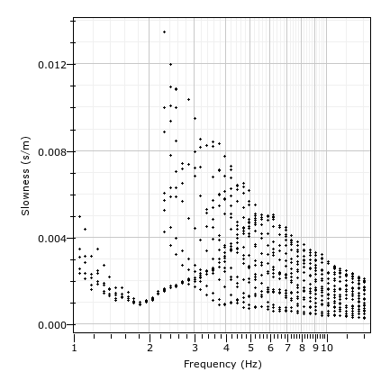

If you try to load a .target file produced by the SPAC plugin in geopsy, there is no chance to get a dispersion curve in dinver.
As I mentioned in my first reply, if you want the dispersion curves for each individual spac curves you have to record the small black dots on the dispersion curve plot in spac2disp (loop over all frequencies and rings with the scroll bars). This is tedious and prone to generate a lot of mistakes.
Alternatively, I have to add an option to spac2disp to let this kind of output. You'll have to wait for release 2.1.0.
With the future release you will be able to get directly the solution in terms of dispersion curve. Here is an example:
spac2disp -dispersion -kmin 0.01 -kmax 0.2 | grep -v "#" | figue -d
kmin and kmax set the range to search for solutions. The best is to first open spac2disp without '-dispersion' option. Identify kmin and kmax in the graphical interface. Restart spac2disp with '-dispersion' option and the appropriate k range.
