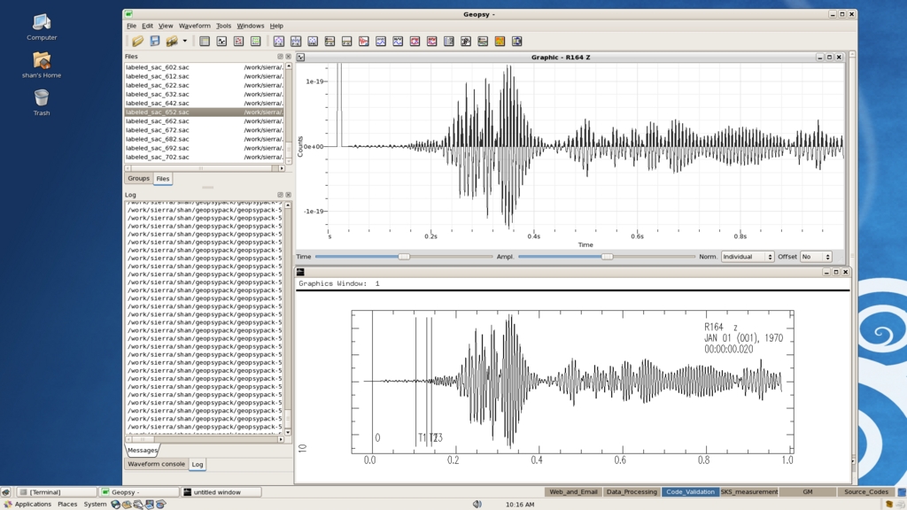

Thank you very much for the help! Sorry for getting back to this so late. Indeed, it is because the receiver coordinates needed to be corrected. After manually doing the editing in the table, now I can get dispersion curves.
However, I have one more questions. My SAC format inputs are a group of synthetic seismograms that are supposed to have very clean onset. I did not spot any problems when I check the waveforms in MATLAB or in SAC interface, but there are big spikes present that are quite close to the starting time of the time series. Why do these spikes show up? Are there any pre-processings that I should apply to the time series to avoid having spikes?
I attached a screen shot of the graphic window. We can see the spike that I mentioned above showing up at around 0.017s after the beginning of the time series.

Can you re-send the screen snapshot with a lower display gain? Play with mouse wheel button while pressing SHIFT to decrease amplitudes. I'd like to see the exact shape of these spikes.

Sure. I attached another screen-shot in this post.
(257.67 KiB) Not downloaded yet
This jpg image only contains seismogram from one receiver so as to get a clear view of the spike. For comparison, there are two panels present in the displaying window -- The upper one is geopsy graphic display and the lower panel is a display window from SAC software. I drag them together for comparing them roughly side-by-side.
The geopsy image is not scaled to its real maximum amplitude. As you can see, the signal is normalized by the maximum amplitude of individual traces, and the current scale on the vertical axis is around 1e-19, which is consistent with SAC header information "DEPMIN = -1.275487e-19, DEPMAX = 1.256976e-19". However, the geopsy seismogram should have been normalized by the maximum amplitude of the entire trace, which should then set the vertical scales to be around 1. Could it be possible that my original seismograms have quite small amplitudes that somehow challenged the numerical stability in geopsy displaying tools?
I will experiment with multiplying factors to the original synthetics to see whether I can then get rid of those spikes. If you have any insights or suggestions, please let me know!
Many thanks!
P.S. The reason I did not show the full-scale spike is because I would need to scroll mouse wheel button for quite a while to change the scale from 1.0e-19 to 1.0, and somehow the sliding bar at the bottom of the graph window for amplitude control is not a quick fix either. This brings in another question: Is there a direct editing way to specify the vertical scale of the plot that one wants to have, something like xlim(), ylim() functions in matlab? Dragging sliding bars or scrolling mouse wheel button is convenient and flexible, but sometimes it might be faster to type in numbers to make quick change of the scales. Thanks a lot!

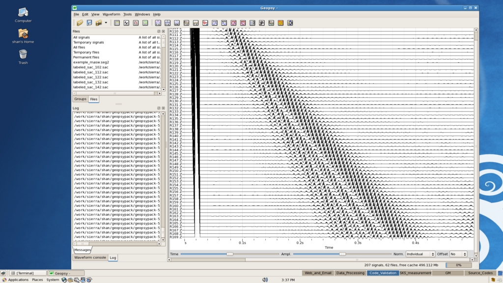

After multiplying the SAC files by a factor of 1.0e+19 (Does not have to be this number, but I tried to get the resulting amplitudes have min/max close to -1.0/1.0), the spike is no longer there. However, I ran into another problem here -- Somehow signals displayed in my geopsy graphic window are no longer normalized by maximum amplitude of each individual trace. If I only plot one seismogram, I can still change the vertical axis gain by pressing shift key whiling scrolling my mouse wheel button. When I dragged and dropped multiple traces into the displaying window, I cannot effectively change the vertical axes scales and each trace does not seem to have been normalized correctly either :cry: . I might have set certain values way off the scale accidentally, and the property seem to have been locked to be what it is until I can find it out and make changes. Would you please let me know what might have caused the malfunction of multiple traces' display in this case?
