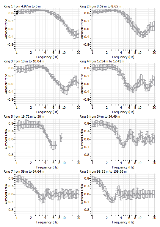

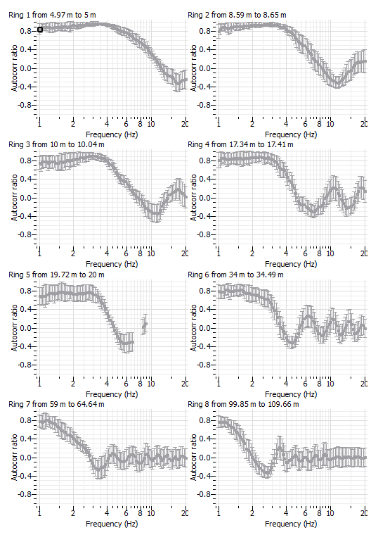

Post by malte »
I came across the problem with the missing values in the autocorrelation ratios again (see screenshot, Ring 5). The reason was a number of zero values at the end of two seismogram traces involved. I guess the algorithm doesn't like that and somehow crashes.
Maybe this can be fixed by doing some checks while generating the time windows?
Cheers, Malte
