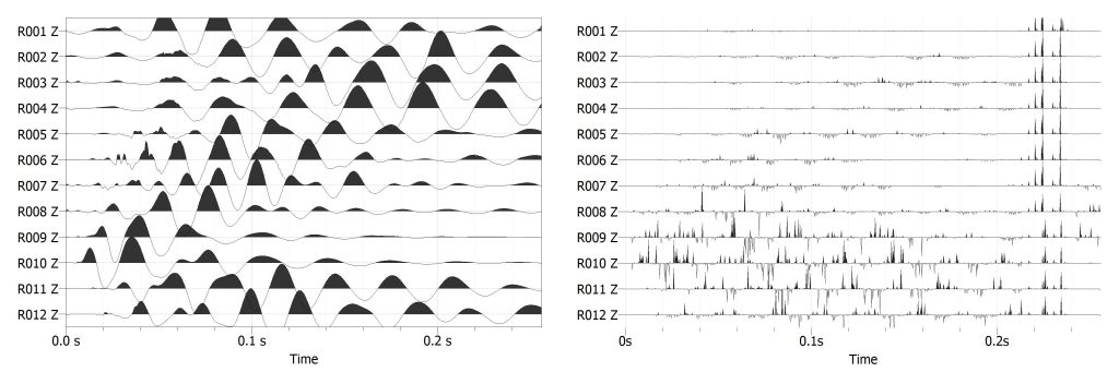

Bonjour Marc,
I read the same file with 2 versions of geopsy (2.6.3 and 2.7) (using window 7). This file comes from a classical GEODE acquisition system. I have checked the parameters they are all the same (frequency sampling, dt , number of samples).
The view is drastically different (see attached files).
Any idea of the problem?
- comparison of both geopsy version for reading a file (I let you guess which one is the more recent version)

This is now fixed for the next minor release (geopsy pack 2.3.1).
Effectively, for geopsy version 2.6.3, corresponding to GeopsyCore library version 3.2.3, loading of SEG-2 with 20 bit floating-point format (based on Digital field tape format standards -SEG-D (2.5-byte binary exponent data recording method, demultiplexed) was working with a rather ugly code. Since then this code was cleaned up but probably not tested because this option for SEG-2 format is not so common. Now the code is clear and correct.
Thanks for your report.
