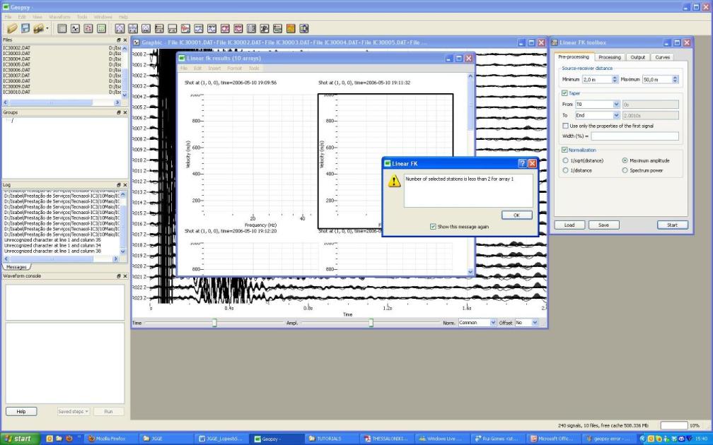

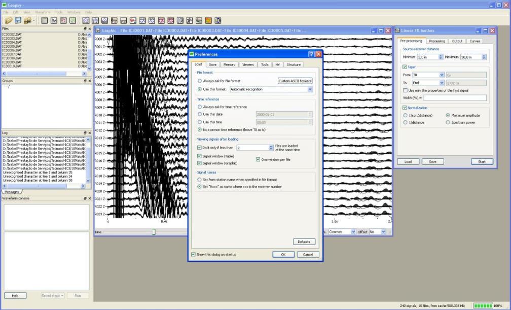

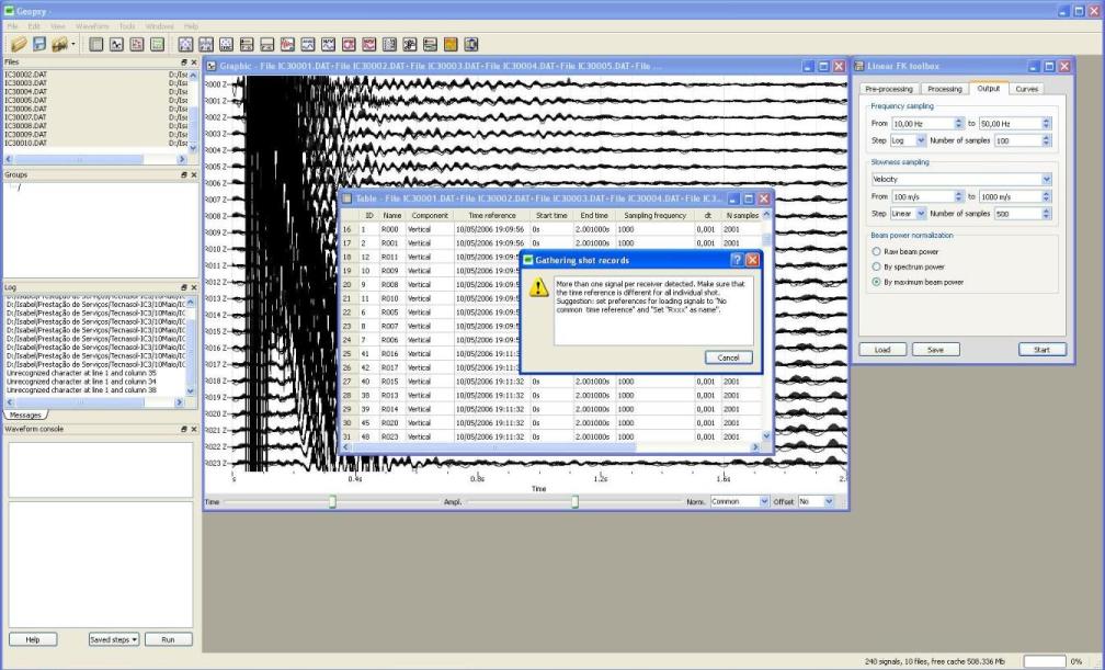

I am starting to use geopsy and probably I am doing something wrong. But I have done what you told me and even used the code you sent and it keeps giving me errors. Now also when trying fk processing.
It happens also when I have only one signal opened.
Please see the attached files.
Thank you.

Can you do the following:
- select all files as you did in the figures sent here above
- drag them to a table
- click on File/Export
- select "Table" format
- post the exported file on this forum.
