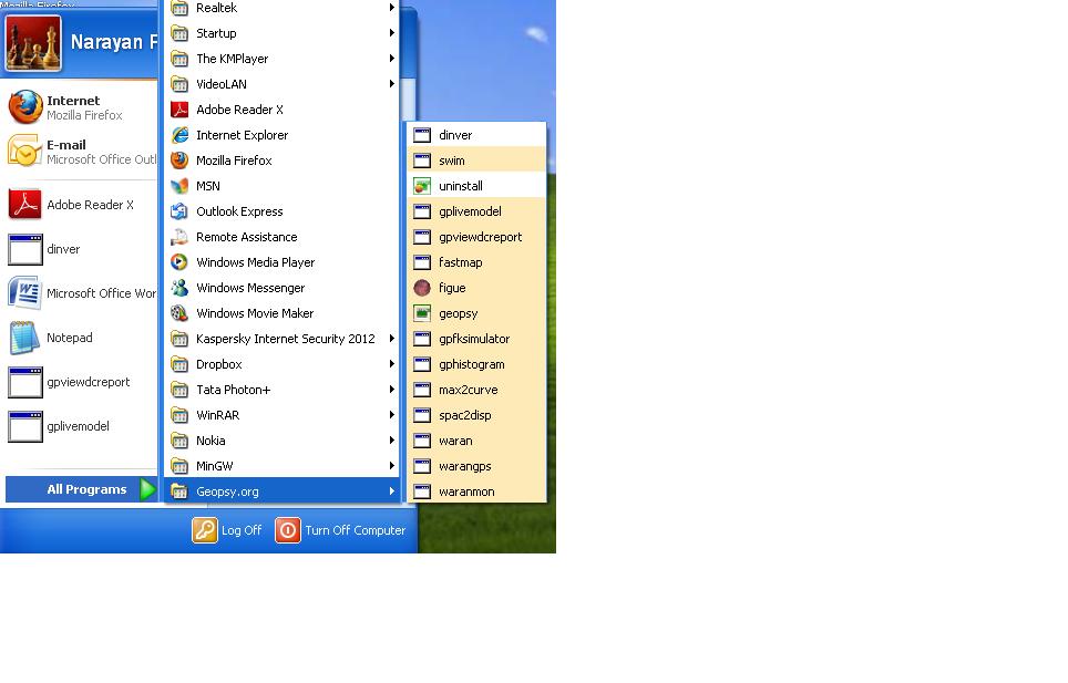

Another problem i am facing..I have installed full geopsy software..I am not getting gpdc tool...I need this tool for forward computation...Only some limited tool is available...I have attached a screen shot of the tools available...
