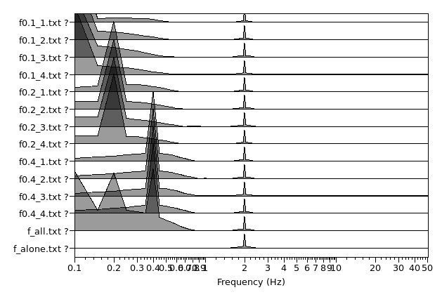

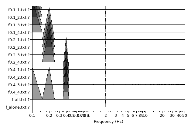

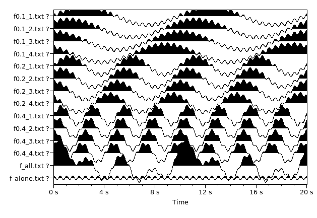

Effect of high-pass filter before cutting time windows
Here are some pictures for a synthetic signal made of simple harmonic functions (generated with http://www.geopsy.org/documentation/gpsignal).
- f_alone is a cosine at 2 Hz
- f0.1 is two cosines at 0.1 and 2 Hz
- f0.2 is two cosines at 0.2 and 2 Hz
- f0.4 is two cosines at 0.4 and 2 Hz
- f_all is 4 cosines at 0.1, 0.2, 0.4 and 2Hz
- Signals in time domain, without tapering:
- Signals in frequency domain, without tapering:
- Signals in time domain, after a taper:
- Signals in frequency domain, after a taper:
- Raw input signals in time domain, without taper
- (26.32 KiB) Downloaded 373 times
- Raw input signals in frequency domain, without taper
- (20.88 KiB) Downloaded 374 times
- Tapered signals in time domain
- Tapered signals in frequency domain
