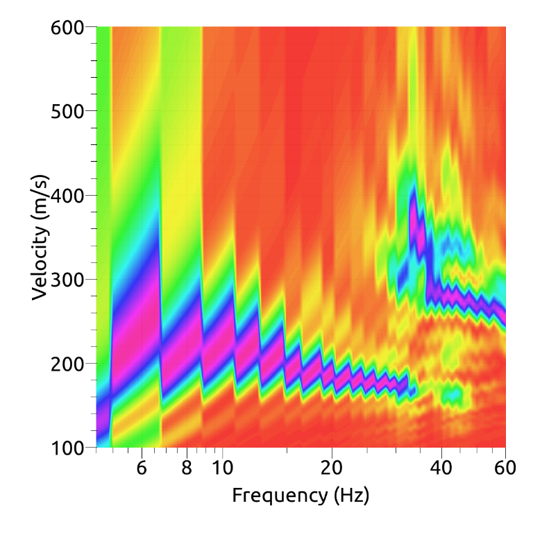

Hello dear admin,
my problem is that the resulting dispersion image from linear f-k toolbox of my data shows a serrated progression (see example image). After trying all offered options from the toolbox I was not able to get a smooth curve progression.
The survey design was adapted to a linear MASW survey (30m offset, 48 channels, 1 m spacing of receivers, 0.512 ms recording interval).
Since I thought to avoid a poor spectral resolution, with named recording parameters, my guess would be a missing zero padding in space.
Could this be possible? Do you have any ideas to improve the image (beside using HRFK)?
Sincerely,
Maik
(363.54 KiB) Not downloaded yet
Re: serrated curve in linear f-k
This is probably due to a rather short time window which results into a large sampling interval on the Fourier spectrum. You can choose a larger time window (second tab in toolbox) even larger then the available data. Geopsy will set all missing sample to 0 (zero-padding). It will make the spectrum denser and hence will smooth your curve. Theoretically speaking you are not adding any distortion to your results. Make sure that you are also applying a taper the data (first tab in toolbox).
