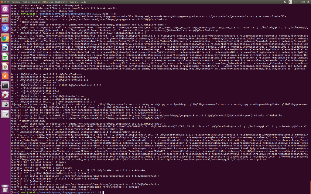

Hi everyone,
I am a Windows friendly user, and I am struggling to instal and download Geopsy.
First, I downloaded the package (from the page http://www.geopsy.org/download.php), in the path : /home/remi/anaconda3/envs/obspy/geopsypack-src-3.2.2
From this folder, I read the "INSTALL" file, and follow the configuration step, by taping in the terminal : "./configure". At the end of the configuration, I receive the message : "GeopsyPack is now configured for building.". But then, when I excecuted "make -j 8" in the terminal (or even only "make", which is only slower), I end up with the error message (see the attached screenshot).
I am sorry that the message is in French, but "a échoué" means "has failed", "ne peut trouver" means "can't find", "on quitte / on entre dans le répertoire" means "entering / quitting the directory".
I hope this is a classic error (even if I couldn't find any solution on the internet so far, nor this FAQ). Hoping for your help :)
Have a nice day between,
Rémi

Hi everyone,
I have partially solved the problem, by intalling again the missing "-llapack" and "-lblas" libraries. By now, when I start the "make", I get :
g++: error: /home/remi/anaconda3/envs/obspy/bin/../x86_64-conda_cos6-linux-gnu/sysroot/usr/lib64/libGL.so: Aucun fichier ou dossier de ce type
Makefile.Release:621 : la recette pour la cible « ../lib/libQGpGuiTools.so.2.2.0 » a échouée
make[2]: *** [../lib/libQGpGuiTools.so.2.2.0] Erreur 1
make[2] : on quitte le répertoire « /home/remi/anaconda3/envs/obspy/geopsypack-src-3.2.2/QGpGuiTools »
Makefile:42 : la recette pour la cible « release » a échouée
make[1]: *** [release] Erreur 2
make[1] : on quitte le répertoire « /home/remi/anaconda3/envs/obspy/geopsypack-src-3.2.2/QGpGuiTools »
Makefile:210 : la recette pour la cible « sub-QGpGuiTools-make_first-ordered » a échouée
make: *** [sub-QGpGuiTools-make_first-ordered] Erreur 2
I noticed that some people have seen my message but didno't answer. Do someone has the answer?
Have a nice day guys and thank you in advance, because I really need a solution quickly unfortunately...
Rémi

Re: Installation problem (Ubuntu 16.04 LTS)
reading your numerous posts, it is unclear if you are compiling under a classical Ubuntu environment or if it is linked to anaconda (I've never used it and I do not know what could be the effects on geopsy compilation.
Just a prerequisite, did you installed the packages listed there?
The missing libGL.so is linked to graphical part of Qt libraries. Apparently, all core libraries were fine but it blocks at the first GUI library.
