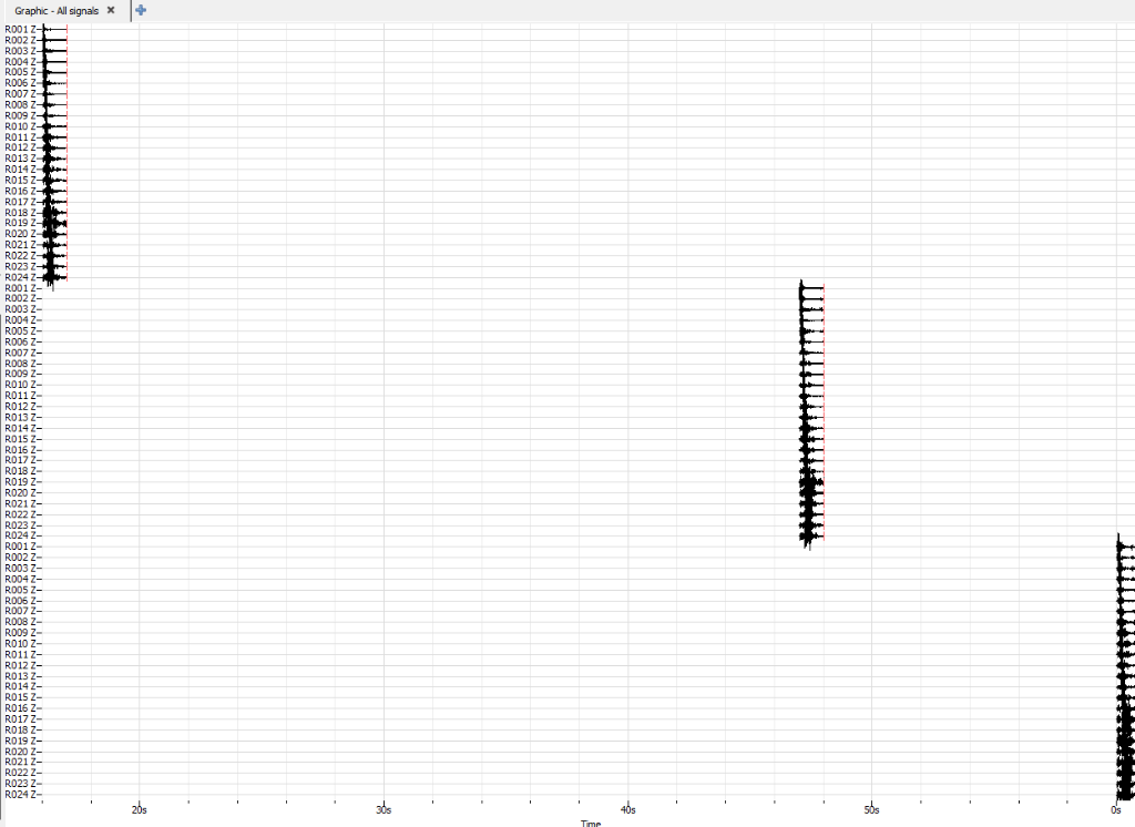

Hi, I ask you for help to solve 3 problems on new version 3.2.2. on W7 x64.
1) When I load the seismograms and display them I get something like in the figure, while in previous versions they were displayed correctly.
2) Then when I run Edit Set Source nothing happens.
3) For example, if I add an Event with Hammer and a distance x=4 m and Force z=-1 then carry out an Active FK analysis, nothing appears in the graphic box, but only the wording FK 0 Source!
Tank's in advaced.
Best ragards.
Stefan menarinis
(128.43 KiB) Not downloaded yet
Re: bad simogram visual, 0 source FH, no Edit source
Hi Stephan,
1) Geopsy 3.x.x is working only with absolute timing (precise or not), so the default plot is like your snapshot. There is an option in "Properties/Layers/Signals/Time scale" which lets you plot relative times. Once you close the graphic viewer, options are saved for the next usage. If you have several open graphics, only the properties of last one are saved (upon closing it). In 3.2.2, this plotting mode is not completely debugged but I'll try to fix it in 3.3.0. In the active FK tool, you can switch to each individual shot: axis are automatically adjusted to produce a more conventional signal plot (even when absolute time scale).
2) "Set source" are remains that should have been removed earlier. It is removed in 3.3.0
3) The event table replaces the source columns in signal properties (see SRL paper in section "Event table"). The absolute time of the hammer shot must fit with the signal absolute times. In your case, you should have three sources. Note that the force direction is currently not used by the active FK tool. 3C version of this tool under preparation will use it.
Hope that I answered part of your questions,
