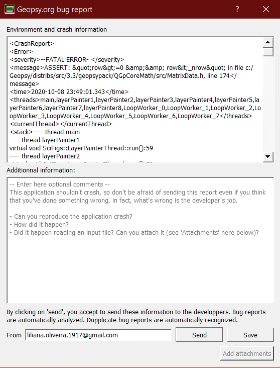

I try with the 3.3.2 version and it still crashes.
When I test with the parameters of the tutorial I obtain the attached message.
I don't understand what it can be.

Re: Geopsy 3.2.0 crash w/ 3 component files
Hi Liliana,
Did you try high resolution FK (RTBF) for 3 components or conventional FK? With 3.3.3, only the last one crashes. 3.3.4-preview (accessible for Linux and Mac when compiling from git repository) fixes everything. 3.3.4 will be soon available also for Windows.

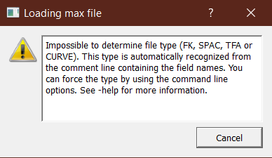

However, when I want to open the .max file in max2curve it didn't open and gives the attached message.
I didn't find a way to fix the file type. How can I do that?
Hi Liliana,
max2curve is an old tool left only for post-procesing results of HVTFA. For .max produced by FK or SPAC, you have to use gphistogram or gpviewmax.

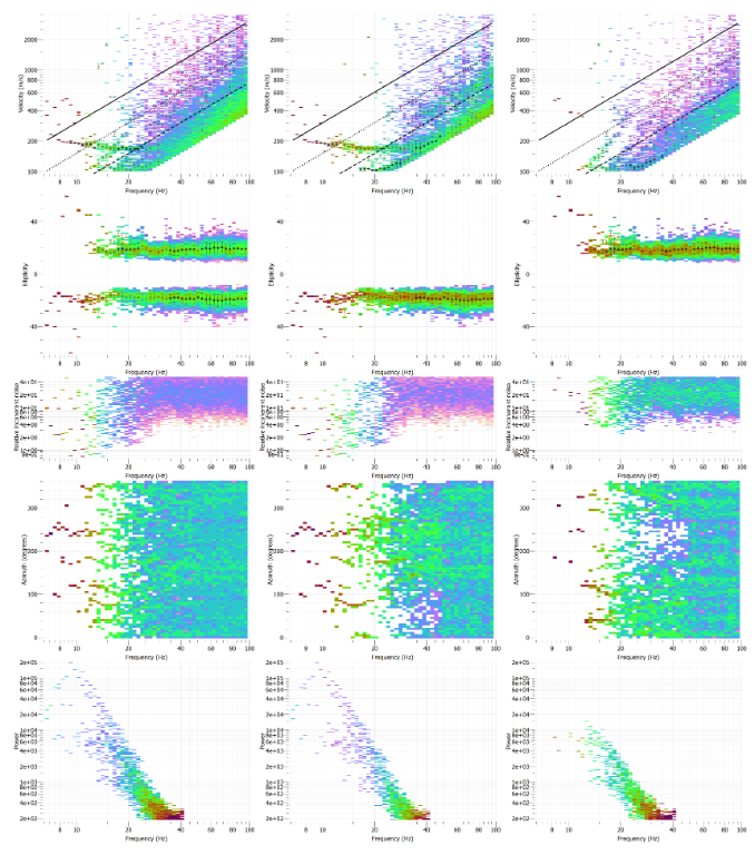

Now I can open the *.max file in gpviewmax, but I don't understand why I have three groups of the same figures. An example is in the attached figure.
Can you please clarify for me?
