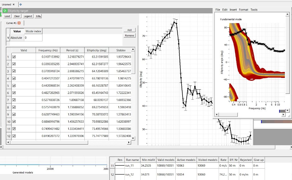

Using Dinver from Geopsy releases 3.3.0. and following I verified that the ellipticity curve is loaded in degrees (in absolute or signed value) instead of in amplitude as in previous versions. When I check the result, the plot appears with only the theoretical curves and the measured curve is missing. Sometimes it appears but very far from the models and often does not appear at all. I tried to select signed or absolute, but I don't get any positive results. This happens whether you use the complete curve or only the right side (as you suggest in curves without singularities). Can you please tell me why this happens and how I can go about overcoming this problem (provided it is not a bug)? I am attaching a picture for a better understanding.

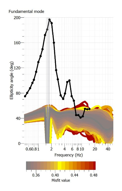

The first strange thing in your figure is the value of your data curve. Values must be restricted to -90 to 90 deg (or 0 to 90 deg. for absolute value). How did you import the curve into Dinver? 0 deg. corresponds to a null ellipticity, 90 deg. to an infinite ellipticity.
If you have a positive ellipticity and if you select "signed" ellipticity, Dinver will try to fit only with positive ellipticities. With "absolute", the sign is ignored when computing the misfit. Your data curve must be positive but the simulated ellipticities can be either positive or negative.

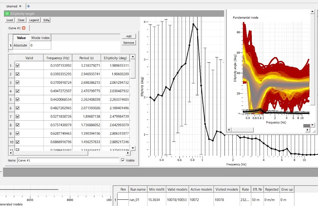

After your answer I uploaded an ellipticity file calculated by HVTFA as you can see from the attached images. In the first figure the second column of the parser shows the amplitude (atang) of the ellipticity and the corresponding graph. I have associated the ellipticity curves picture of the inversion expressed in the degree scale.

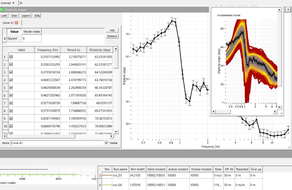

In the second image I modified the input file with the degrees option and the representation is in degrees. The inverted curves were calculated with a parameterization previously tested with Dinver of the snapshot release. As you can see the misfit is absurd. In the third image the input data are always the same but this time the misfit appears acceptable.

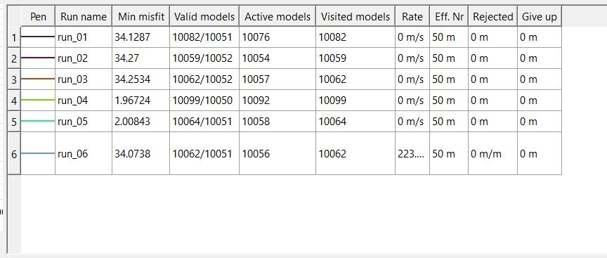

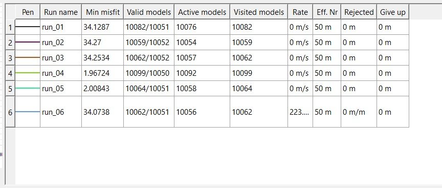

The anomalous thing is that the next run, without changing anything at all, the misfit returns exaggerated. In the fourth image I represented the misfit of a sequence of runs from which it is appreciated how the outputs are unreliable and the correct solution is absolutely random and not repeatable with the next run.

The ellipticity value are all very low for an ellipticity in degrees. Probably in the parsing filter the type of column was not set properly

The range of values looks better for degrees. What's wrong with the inversion is that dinver tries to fit the curve with a signed ellipticity, even though "absolute" was selected.

I have no idea of the target defined for each run. Run 4 and 5 are probably corresponding to target of dinver2.jpg. Other runs to the other targets.
