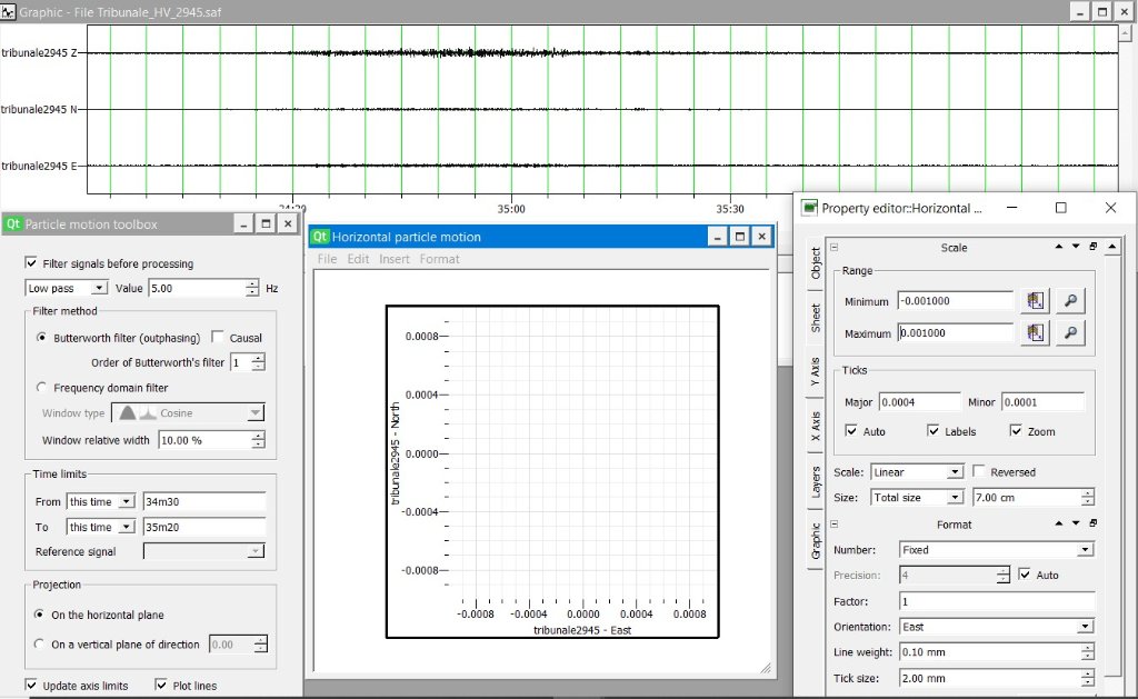

In version 3.3.2 that I have installed it seems to me that this tool does not work: no plot appears as you can see from the image.
The mistake of the orientation of the axes observed in this case is also valid in the Waveform - Rotate components (where however the direction of the anticlockwise rotation is specified)?

Re: Axes in particle motion plots
The plot is there but very small. If you manually change the size with the properties panel you can recover it.
This issue is fixed in 3.3.3

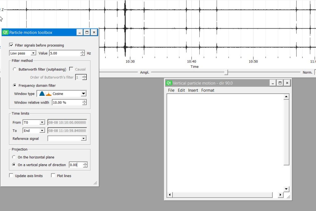

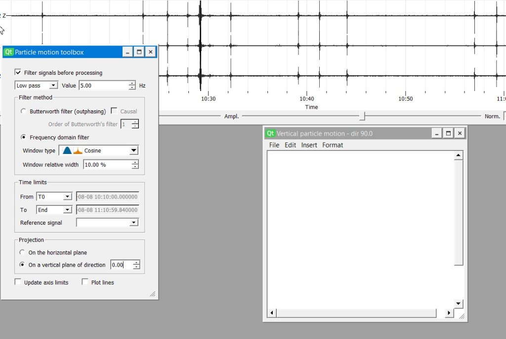

As suggested I have manually expanded but as you can see the plot is empty and this happens on all releases after 2.9. The one shown is related to release 3.3.3. and the same happens with 3.3.4.
So I have to keep several releases active on my PC to take advantage of all the potential of Geopsy tools.
Sorry, but I made a mistake by not using the correct data format which must be complete with the date. So I was able to verify that the tool works, but the need to manually set the size of the object remains.
(108.1 KiB) Not downloaded yet
See this topic for the probable reason why it is not solved in 3.3.3 and 3.3.4.
I'll add a note in topic 414 when the new archive are available.
Sorry for these long lasting errors. I did not suspect such an error.
