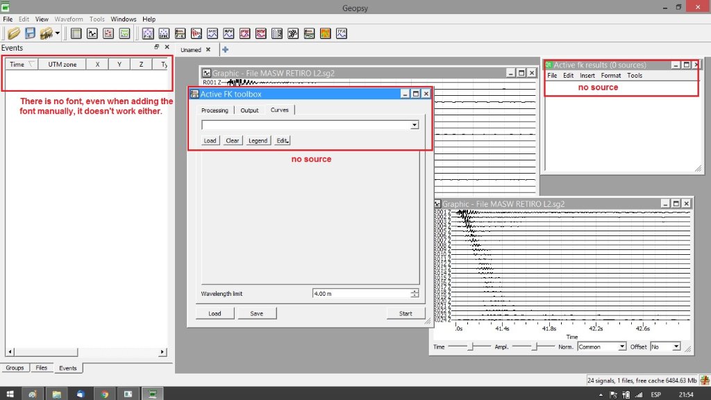

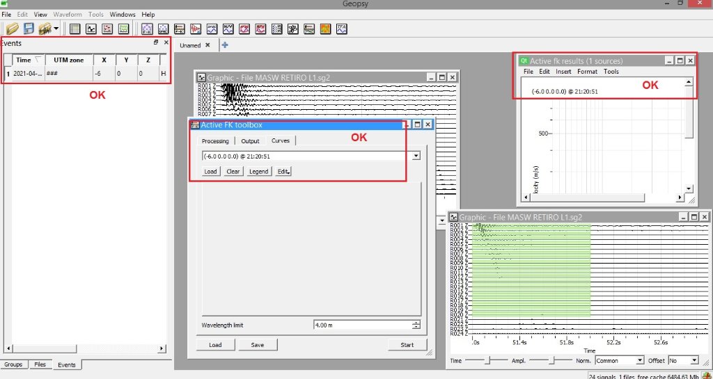

Dear, I installed version 3.3.6 and when analyzing a file in FK-active I have no problems (source and receivers are entered) and it returns dispersion curve, however, when analyzing a second FK-active file, in the events screen The option to enter SOURCE does not appear and I cannot process due to this lack of data. I tried this second file by closing and reopening GEOPSY and the problem continues.
I attach explanatory files and Error Report.
Thanks!
problem processing FK
- Error 170421.zip
- (2.81 KiB) Downloaded 5726 times
- (86.8 KiB) Not downloaded yet
- (87.41 KiB) Not downloaded yet

The error you got on exit are warnings that are fixed in 3.4.1.
If the event table is empty, you have to add manually an event (context menu). It must be at the same time as your recording and the location must be also correct. With SEG-2 format, usually the events are automatically added.
If you still cannot process it, send me a file example.
