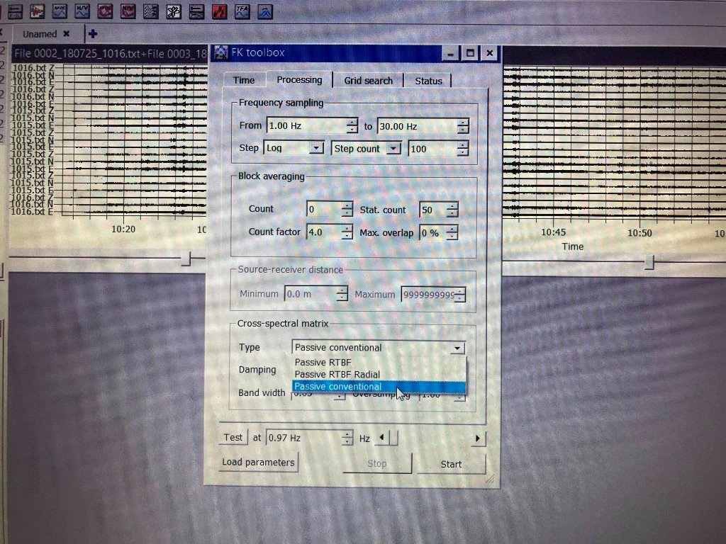

caponTransverse is not on processing list of 3.4.2 release
as you wrote in a my previous post the CaponTransverse isn't in the processing list of 3.4.2 release, as you can see on the pic attached.
(213.61 KiB) Not downloaded yet
Re: caponTransverse is not on processing list of 3.4.2 release
It looks like the list of 3.4.1. Can you check that the plugin path is not pointing to the previous release?
Start from GeopsyLand:
$ geopsy -clear-tools
And then restart geopsy normally.
Hi Marc, ok!
Now there is the complete list of FK processes!
FK conventional, HRFK and RTBF.
I have to remember to delete all the previous tools before to install the new release.
