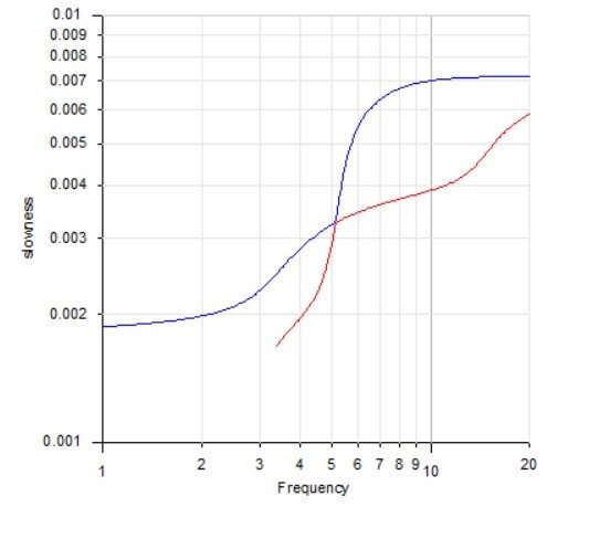

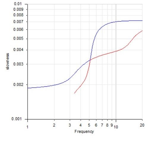

could you please clarify me why you defined the osculation point at about 8Hz?
Calculating the dispersion curves for the Pedro.model it turns out to me that the osculation point is close to 5Hz (see images) ...
What am I doing wrong?

Re: Gpell Error: "Error computing ellipticity curve (eventually increase verbosity to debug)”
I worked only the first model provided by Pedro (3 layers). Effectively the 4 layer model has an osculation point around 5 Hz.
