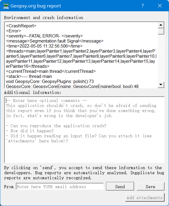

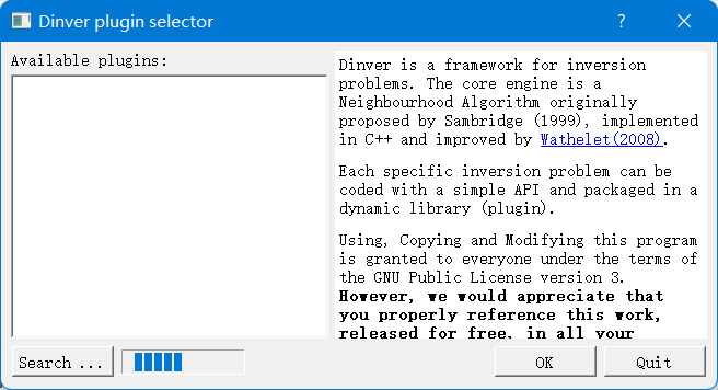

After I switched to a new computer, my geopsy didn't open and showed a bug report, and there were no plugins in the Dinver module that could be loaded, just like the pictures in my attachment.
I have uninstalled and reinstalled it several times, but nothing works. Strangely, my old computer still works properly. I don't know how to solve the problem.

When you get such bug report, it is better to copy the text of the report instead of a snapshot.
I think that the solution is relatively simple. If you are under Linux, just run
geopsy -clear-tools
dinver -clear-plugins
If you are under Windows, open "GeopsyLand". On the right panel, there is a mini emulation of a bash terminal. Type the same commands.
These commands are usually required when multiple releases are installed on the same machine.

Thank you very much! Those problems have been solved. Best regards.
