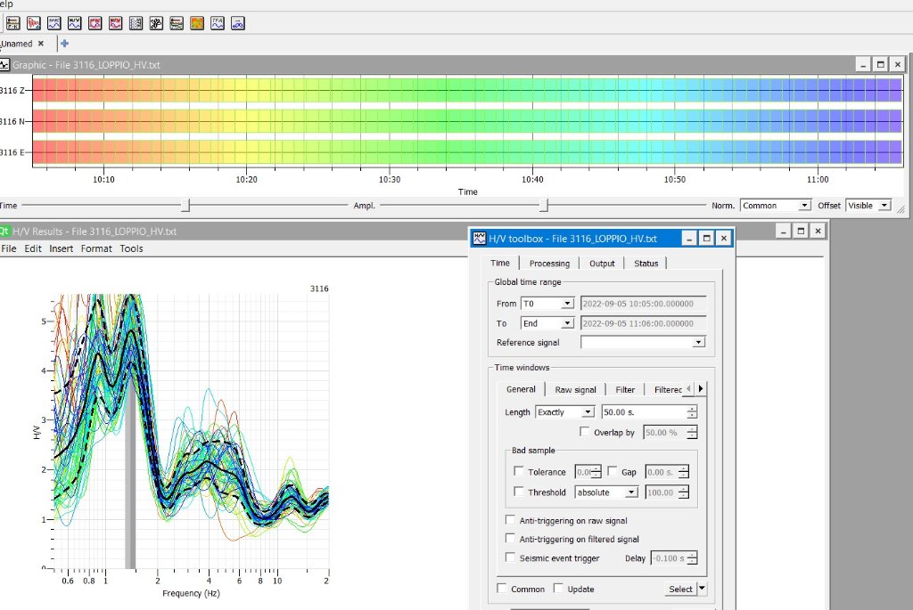

I can't see the waveforms anymore. All tools work correctly.
I deleted and reinstalled Geopsy, but without success.
What should I do to restore the view?

Have a look into the properties of the plot. Under "Layers/Signals", "Overlap traces by" should be at an abnormally low value. Set it to 1. That's the first reason I'm thinking of.

Done!
