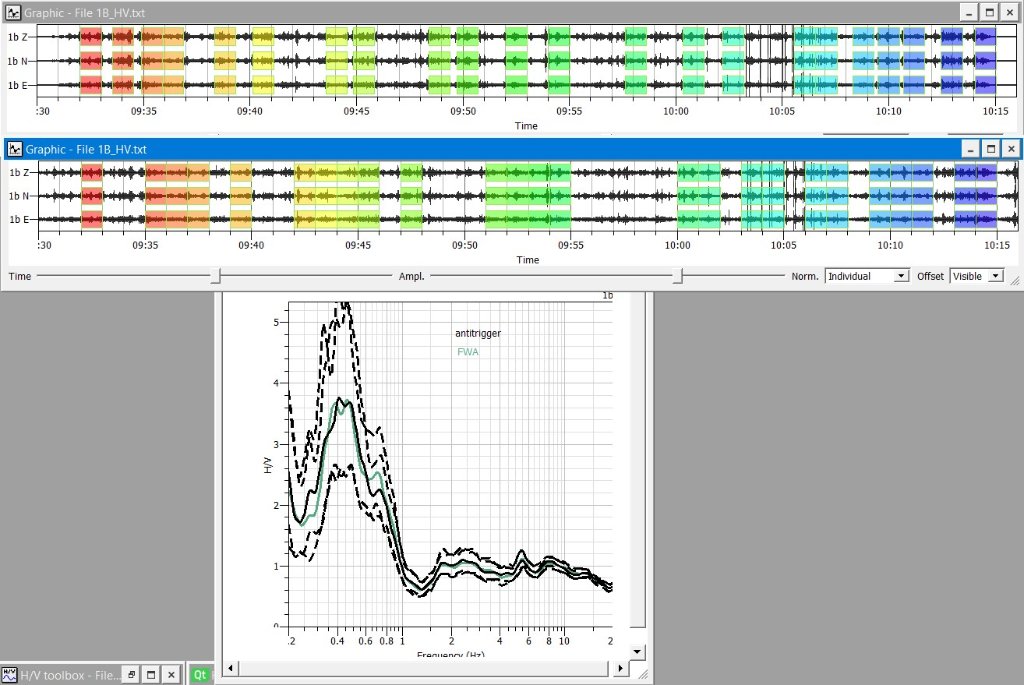

I have made many comparisons between antitrigger-FWA H / V curves and to have a comparable number of windows it is often necessary to use values of n <2. In the attached image the FWA curve has been constructed with n = 1.4 (the highest time series are FWA)
(127.87 KiB) Not downloaded yet
