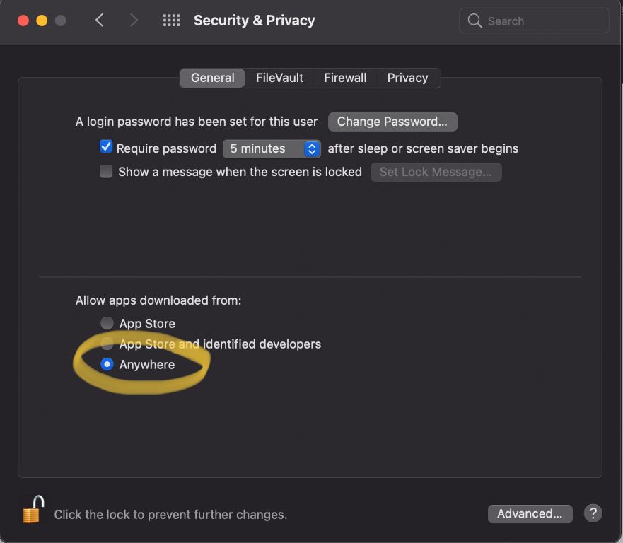

OK, I have a solution:
In the latest versions of OSX the gatekeeper setting (Security & Privacy settings) to enable opening of apps from any source is hidden by default.
I was able to unhide this setting by running the following code
sudo spctl --master-disable
(189.95 KiB) Not downloaded yet

Thanks for your report and the solution.
