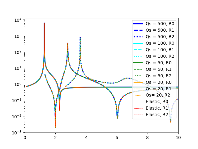

I'm using gpell for a number of 1-D models that include Qp and Qs, and have found that there seems to be no change when either adding or changing Qp / Qs in the models, as exemplified with the attached models & resultant ellipticity curves. I've tried this for a number of other models and also with Geopsy 3.5.2 and 3.4.3, with no success. Any ideas on this?
- (72.83 KiB) Not downloaded yet

Hi Ian,
Effectively, gpdc and gpell do only elastic computations. Qs and Qp are included in the file format to get a unique format for 1D structures. The format is also accepted by gpsh which makes use of Qs and Qp.
