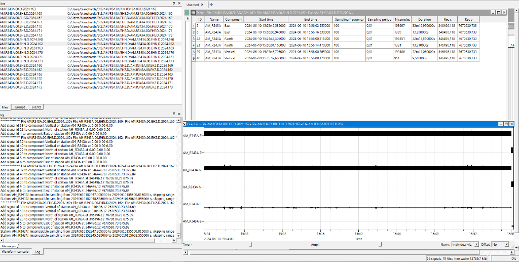

In fact, some Julian days are only recorded over a few hours (or even a few minutes... Certain technical problems with the seismometers persist...). However, I would still like to use this data. I'm sharing with you a screenshot of Julian Day 162 as an example of an attempt at H/V processing. The logs show that the samplings are incompatible, yet each portion of the signal has a sampling frequency of 100 Hz...
The names are identical, as are the coordinates...
I'm not sure how to identify this error.

The resolution of the snapshot is too low to clearly distinguish numbers for the starting times. However, I can read that they differ by a few ms which is lower than the sampling period. For H/V processing you can safely round them to the sampling period, because the phase is not exploited. That's strange that even the E, N and Z components do not have the same starting time.
You can run the following script with menu Edit/Set Header:
https://www.geopsy.org/wiki/index.php/G ... ing_period

is there anything I can do to get the startTime property recognized? applying the link code snippet, my log says :
[Header] Uncaught exception at line 6:
[Header] TypeError: Cannot read property 'startTime' of undefined

How many signals do you have in the viewer? Thanks to your post I discovered while answering on June 28th that there was a stupid condition (I have no idea why it was there) to prevent the creating of the object signals[] if there were less than 10 signals. This is now fixed for future release. But meanwhile, unless you are willing to compile geopsy on your machine, you must have more than 10 signals to run the script. Add some fake signals or duplicate the signals to get at list ten rows in the table.
