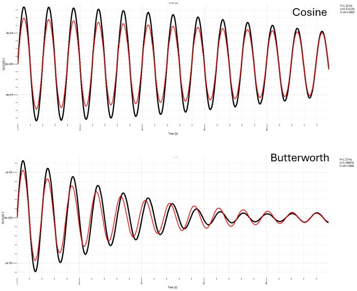

I have a dataset that we are quite unsure if the peak that we are seeing in the vertical component is of industrial origin. I have been testing this hypothesis using damping toolbox but I am not quite sure of which filter method to use - Butterworth vs Cosine taper.
I have tried using a cosine taper and it verifies that our industrial origin hypothesis, however, using a Butterworth filter gives an opposite result.
(68.38 KiB) Not downloaded yet
I used a very narrowband frequency as suggested in the documentation here with 10 s window and fitting length.
Please let me know what you think on the ideal filter parameters. Thank you, as always
Re: Geopsy damping
Hi Leandro,
It looks like that the width of the cosine filter is too small. The damping effect always disappears if the width tends to 0 because the signal reduces to a sine or a cosine function. Try to enlarge a bit the bandwidth and check if the damping is increased.
