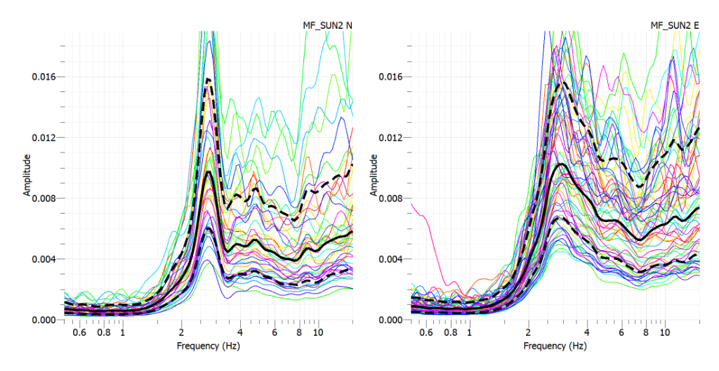

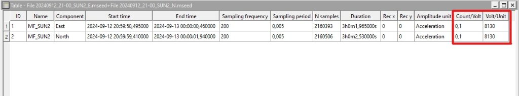

Thank you for your help. Your response helped resolve the issues related to questions 1 and 3. However, I am still encountering difficulties with the Y-axis configuration of the spectrum graph. While I have set the properties you mentioned, I am uncertain about the appropriate values to assign to "CountPerVolt" and "VoltPerUnit." In the previous version, I was multiplying the signals by a conversion coefficient of 0.000123 gal. I would greatly appreciate your guidance on how to determine the correct different from 1 values to assign to these properties.
Additionally, when generating the graph, the title of the Y-axis currently shows "Power spectral density [(counts^2)^2/Hz]," whereas the required output for my analysis is for the title to read "Amplitude" (as in version 2.9.1). Furthermore, the amplitude values on the Y-axis are not consistent with those obtained in the previous version.
For your reference, I have attached images that illustrate the settings of the signal properties in the table (with arbitrary values for "CountPerVolt" and "VoltPerUnit") and the spectra generated for the same signal in both version 2.9.1 and version 3.5.2. I hope these images help clarify the issues I am facing.
Thank you in advance
Fabiola
(93.91 KiB) Not downloaded yet
(442.9 KiB) Not downloaded yet
(28.51 KiB) Not downloaded yet
Re: Changes in Geopsy 3.5.2.
Can you post the log files generated by each version? Standard deviations and individual curves look quite different between the two versions. Were they calculated with the same parameters? There might be minor differences even though the parameters are at the same values because computation evolved (frequency sampling, log averaging,...). Just comparing visually the mean, they are nearly at the same level. One way to quickly compare them is to copy the layers (see context menu on the graph contents) from version 2.9 on top of the graph generated with version 3.5. You can hide (null opacity), remove or re-arrange the layers of a graph in the graph contents properties.
