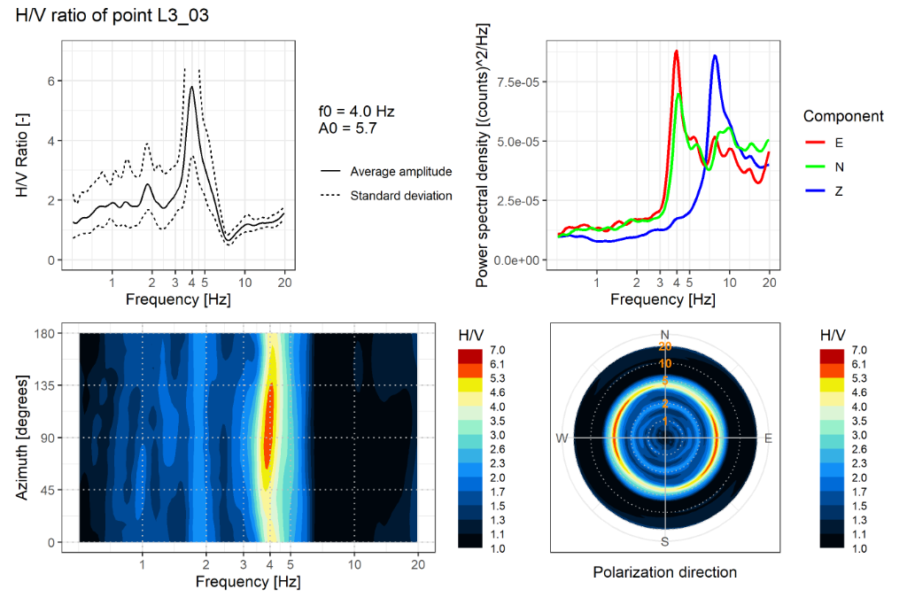

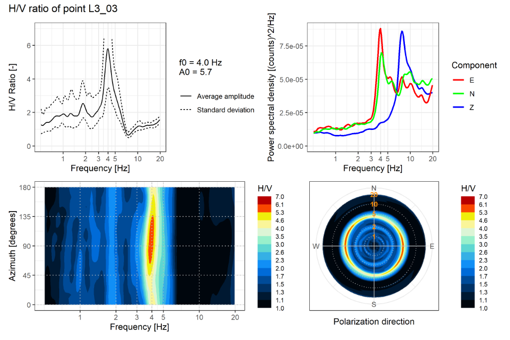

What it does: (see also the two images attached)
- plots the H/V ratio with standard deviation
- plots the Z N E components
- plots the rotation spectrum
- saves the rotation spectrum in polar coordinates together with a world text file for fast visualization in QGIS

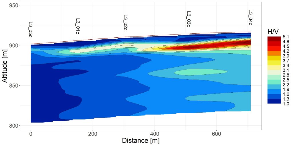

- a separate script plots multiple h/v measurements as a 2D profile, taking a separate DEM for adding topography.
