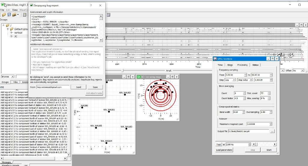

About the first point I tried to run SPAC using your database Lep_ring01.
The tool worked nicely with V data, but crash immediately with 3C data. I attach the screenshots for V and 3C parameters setting (I used exactly your rings dimensions) and, for the last one, the crash report too.

About the second point you are rigth: both kmin and kmax were set to 0.0 (default values because that occurred at first run of this release). Turning to realistic values, the dispersion graph shows the densities grid.
Thanks a lot and best regards
Re: SPAC and spac2disp doesn't run with the 3.3.2. release
OK I could reproduce the error while processing 3C SPAC.
It was a wrong initialization of the horizontal cross-spectrum matrix.
The processing of 3C SPAC targets is still experimental. You must start spac2disp with option '-VRT'.
If not, you will get an error complaining that there are 3 curves per ring.
