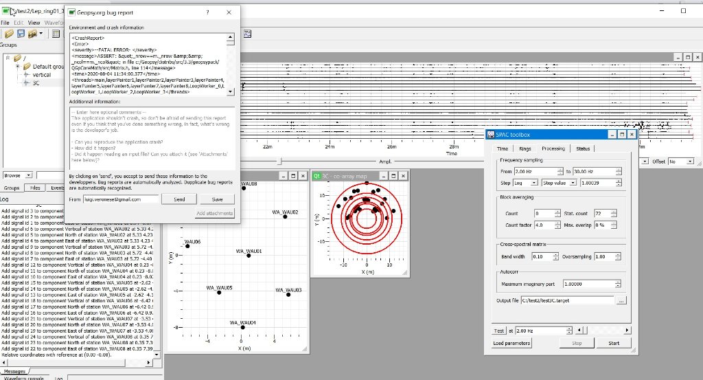

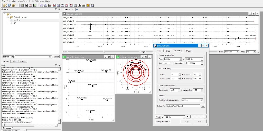

Thanks for answer.
About the first point I tried to run SPAC using your database Lep_ring01.
The tool worked nicely with V data, but crash immediately with 3C data. I attach the screenshots for V and 3C parameters setting (I used exactly your rings dimensions) and, for the last one, the crash report too
(131.76 KiB) Not downloaded yet
(108.22 KiB) Not downloaded yet

OK I could reproduce the error while processing 3C SPAC.
It was a wrong initialization of the horizontal cross-spectrum matrix.
The processing of 3C SPAC targets is still experimental. You must start spac2disp with option '-VRT'.
If not, you will get an error complaining that there are 3 curves per ring.
