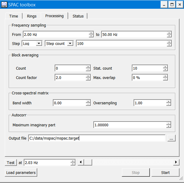

I am interested in comparing dispersion data from the MSPAC and RTBF processing methods available in Geopsy. To make such a comparison I would like to be able to access the data of each time window from MSPAC processing through the production of a .max type file as is available from the RTBF. However, I see that this functionality is no longer supported in the newest versions of Geopsy, with the only option being to export in the .target format with the data already binned for inversion (screenshot attached). I have three specific questions:
- Snip of MSPAC processing menu, with .max option missing.
- (18.28 KiB) Not downloaded yet

This is planned to be re-introduced in a future release (especially, if users are asking for it!).
You probably have to go back to 2.10 or so to be sure to have to feature working.
