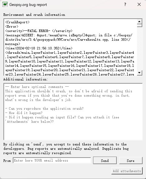

When I use the H/V tool, the software always crashes and I don't know how to solve it.
Attached is the information after the software crash.
Thank you.
Peng Zhao
(74.63 KiB) Not downloaded yet

Hi Peng,
Can you copy the text of the bug report rather a snapshot?

Re: The software crash
Hi Peng Zhao,
From the bug report, I can see that you are running version 3.4.2. Have you ever tried with 3.5.2?
I can also see that you have a huge amount of cores on your machine. If the bug persists with 3.5.2, you can try to run geopsy with a limited number of threads (8 for example). Inside GeopsyLand, run geopsy from the terminal
geopsy -j 8
