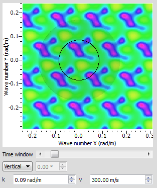

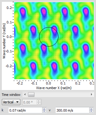

I am new geopsy user. I would like to ask you an issue in my FK analysis.
Why my both CVFK and HRFK analyses using Test button cannot produce a clear pattern as shown in your online manual to obtain propagation azimuth of the wave? See the attached screen shots.
FYI, I am using circular hexagonal array with radius 50 meter with one instrument in the centre.
- (64.75 KiB) Not downloaded yet
- (74.72 KiB) Not downloaded yet
- (56.75 KiB) Not downloaded yet
- (74.36 KiB) Not downloaded yet

Hello user,
this is due to spatial aliasing, maybe your array has a geometric, so you have ambiguety in the range of the wavenumber resolution of your array.
Try to analyze your data in the closest period 2pi/Dmax
