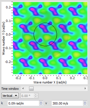

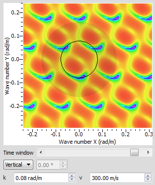

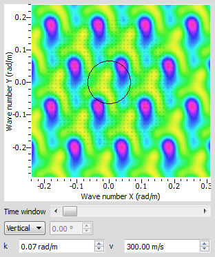

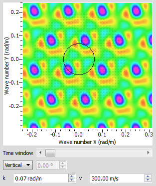

I am new geopsy user. I would like to ask you an issue in my FK analysis.
Why my both CVFK and HRFK analyses using Test button cannot produce a clear pattern as shown in your online manual to obtain propagation azimuth of the wave? See the attached screen shots.
FYI, I am using circular hexagonal array with radius 50 meter with one instrument in the centre.
(64.75 KiB) Not downloaded yet
(74.72 KiB) Not downloaded yet
(56.75 KiB) Not downloaded yet
(74.36 KiB) Not downloaded yet

Post by Roberto Cabieces »
Hello user,
this is due to spatial aliasing, maybe your array has a geometric, so you have ambiguety in the range of the wavenumber resolution of your array.
Try to analyze your data in the closest period 2pi/Dmax
