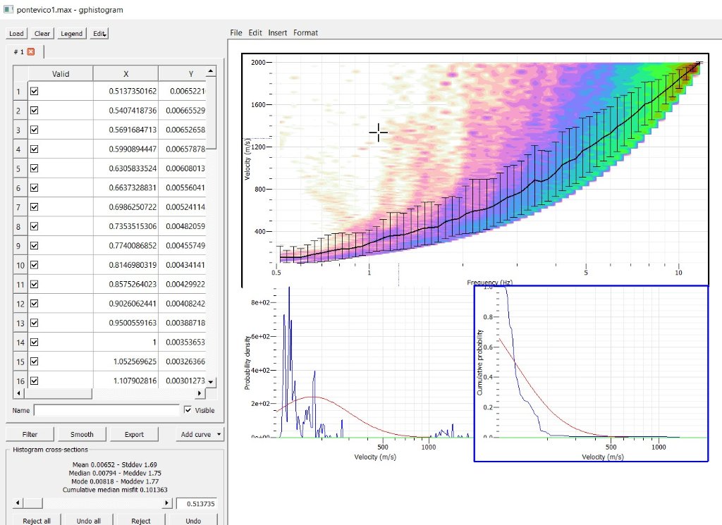

gphistogram have an anomalous grapfic output
I'm a Geopsy user since the first release (2005..or so..).
Now I have installed 3 realease (2.9.0., snapshot -20161121 and win64 3.3.0) on two laptops.
It happens with the last release the graphic output of RTBF on gphistogram shows
the slowness frequency graph (or speed) where the speeds are higher at high frequencies than at low frequencies. Am I making any mistakes in setting the parameters or it is a bug in the program? With previous releases it doesn't happen using max2curve (which isn't in this release).
The database is composed with 5 stations 3C and the records are 2h long.
Another thing, SPAC does not work: just clicked on the icon the program crashes (the same database on previous releases reaches the end of the processing without problems).
I attache a screenshot of gphistogram issue.
Thanks a lot for the anwer and best regards

On you plot the lower limit of the coloured area is due to the GRID_SIZE parameter. If you increase the grid size, the results will be extended to higher frequency and lower velocity. But, for this case, I'm unsure that you will get more results. Can you plot the theoretical array limits computed with warangps on top of your plot? (copy and paste layers from the dispersion plot obtained in warangps).
Did you tried gpviewmax? It is still preliminary release but it helps to plot more results (azimuth, ellipticity,...)
SPAC is now fixed in release 3.3.1

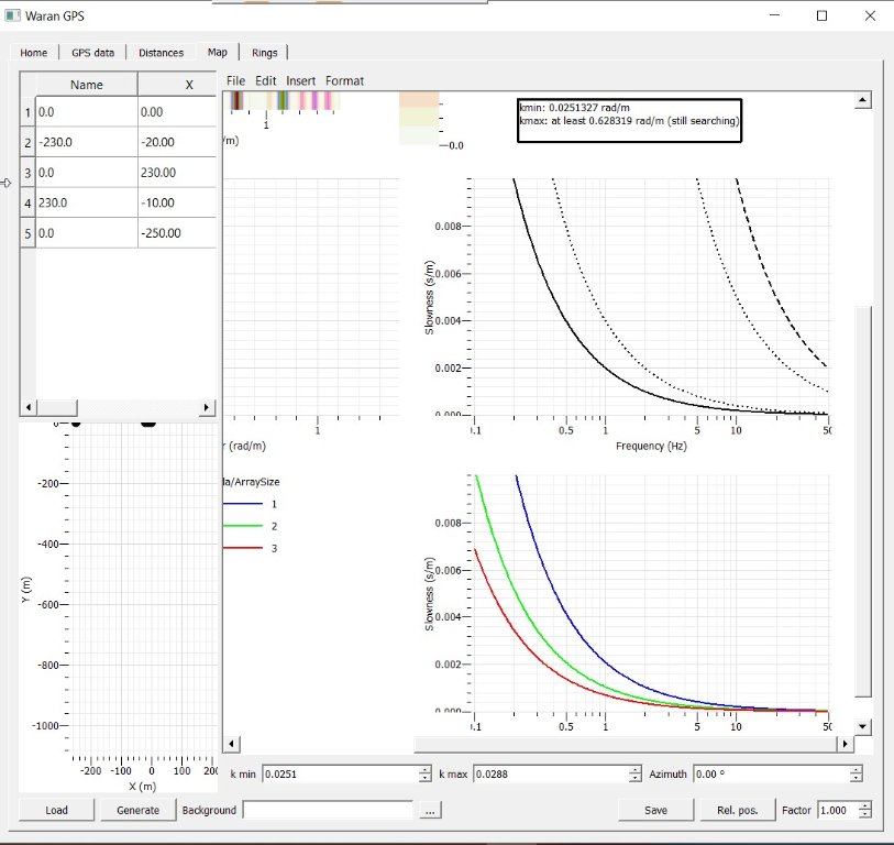

May be I unsterstod the problem. The five stations have a diamond shape array, but the distance between the stations is perhaps very large (200 m, too much?) for F-K analysis and may be the
wave sources are no right on azimuth. In fact I have experimented on a database of years ago acquired for different purposes and now I am waiting to be able to examine more suitable data for radii and number of stations.
Have a good day
Have a good day
Re: gphistogram have an anomalous grapfic output
Sorry, I forgot your suggestion to use warangs.
I did it and I send you the image of the dispersion curves, station coordinates and the values of kmin and kmx.
I hope to have rightly understod your suggestion

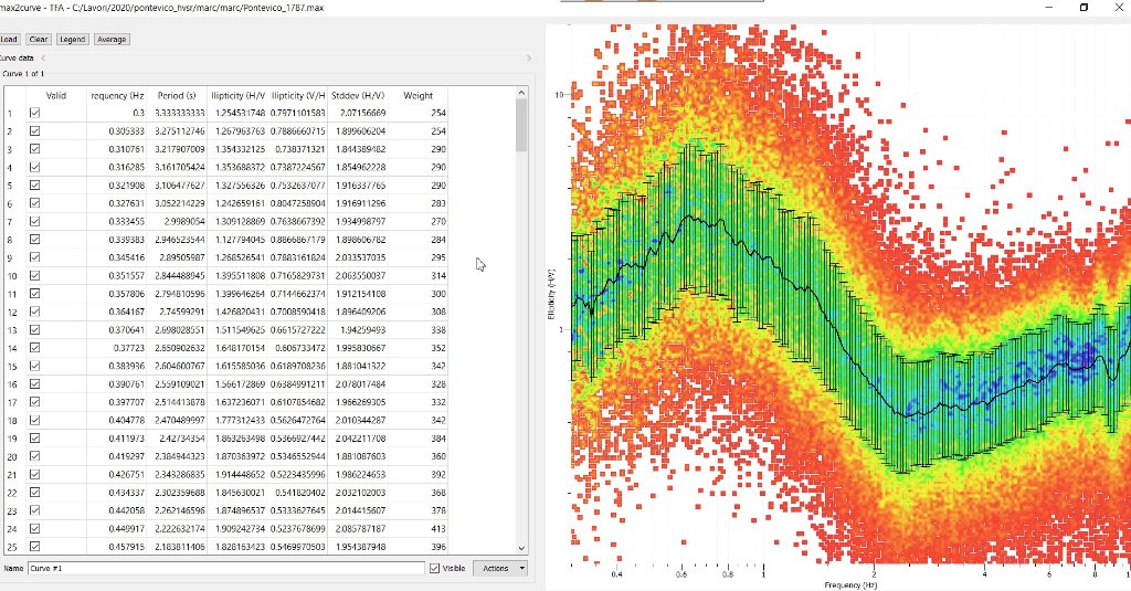

I tried to use the HVTFA tool with your data.
Questions: how many time needs to complete the process? I have been forced to stop because it doensn't finish in a resonable time and the output .max file have a different format from the one presented in Neries technical paper
(# File generated by Geopsy, H/V TFA processing
# seconds from start | cfreq | H/V | AmpZ | AmpH | Delay
9.6 2.00135 0.747509 2169.77 1621.92
9.6 2.00135 0.807737 2169.77 1752.6
21.92 2.00135 1.50149 911.714 1368.93
21.92 2.00135 1.46191 911.714 1332.84
31.17 2.00135 1.07907 2073.86 2237.83
31.17 2.00135 1.19933 2073.86 2487.24
35.76 2.00135 0.503696 1660.05 836.158
35.76 2.00135 0.44642 1660.05 741.079
40.38 2.00135 7.90909 310.292 2454.13
40.38 2.00135 7.99398 310.292 2480.47....)
and is not possibile to open it with max2curve (crash) nor gpviewmax (doesn't start after launch).
I found in your database 3 bug reports concerning the same problem with Windows 10 (2714, 3715 and 3860) and which apparently have never been fixed. I found that using the snapshot 0.0.0. the TFA tool runs and closes the file autonomously, while the 3.3.0-3.3.2 releases do not and I got a 1.6Gb .max file ...!
I found a temporary solution when I found out that max2curve from release 2.9.0. (which does not have the HVTFA tool) correctly opens the max files generated with the 0.0.0 snapshot. At first I tried to replace the max2curve of release 3.3.2. with that one of 2.9.0. (adding the necessary dlls), but it didn't work. What happened with the snapshot instead, as you can see from the attached image. However, I believe it is necessary to fix the bug with the newer releases on Windows.
In my previous post I asked you why in the plot of calculated H/V curves I cannot graphically compare those with the measured one because it does not appear in the plot (the degrees are positive and those of the theoretical curves negative). What is the reason?
